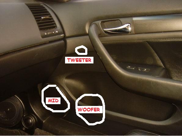

ok as you know, i recently built a pod for my door. after i wired everything up, it sounds great. it sounds way better than when i had it in the kick panel.
anyways, the mid sounded a bit hollow so i put a little bit of polyfill in there and it made it sound a lot better.
my question is this. when i sit in the driver side, the sound is louder on my left ear. when i sit in the passenger side, the sound is louder on my right ear. how can i make it more in the middle?
i am thinking i should aim my tweeters better. they are facing each other. i got some tape and fired both towards me and it helped a little but still its not centered.
so should i go with a aluminum or titanium tweeters? some thing that works well off axis maybe.

chad are the mids aimed at all or pointing directly across from one another?
best way to get a very center soundstage is aiming them towards the dome.. well you do not have to go as high but that general area.. but of course your mids are up high and close to the ear so i think youll have a hard time getting it centered
putting the tweets in the pillars will help but you will notice a strong side still.. t/a will fix it but only for sitting on one side
to completely fix it.. your not going to want to hear it :-) .. but youll need to move the mids
the discolor your hearing.. "hollowness" .. a lot of people fix that by cutting a hole in the back of the pod.. my kicks are done that way.. basically your pod is resonating .. you can try to add some playdoe on it and it might help

i'd really suggest running a 3.5-4.0" midrange in a pod with your tweets.. or tweets in the pillars depending on sound
...i know you don't want kicks but they work very well and if its a small driver you won't have issues with it taking up much space

chad.. have you tried putting them in the kicks with no angle? if not i'd try that.. or barely angle them out
i have a very centered soundstage no matter which side you sit on .. only problem is the sound does not project far enough towards the hood even tho it is eye level
i would not rec the tweeter position you had there on the door.. either mount it near the mid in the kicks or bring it up in the pillar.. with the tweeter that low in your door your staging will be low

alright thanks kevin.
so this is what ima do. ima put the tweets back on the window sail (which is practically the a pillar) and put the mids down low at the kick panel.
then later ima buy a nice 2 way and go with the stock locations (which is pretty much how you described it).
Username: Frkkevin
¤ Resonant Engineering..., ¤ Fort Worth...
Email
Post Number: 4780
well yes and no.. i wouldn't use the stock location for the mid..
just piece together you a nice 2 way and go with some 3.5-4.0 mids and put them in the kicks at a slight angle.. well try them not angled first.. just kinda mount them in some mdf ghetto like to test the sound
