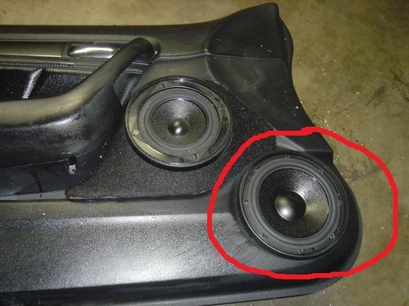

i want to cut a mdf ring. but i need it to be angled so i can angle my speakers. here is a picture of what i am talking about.

well if you see the picture below, i circled the part. see how it angles away? first of all, i want to add a mdf ring there so that speakers sticks out to match the mid. also i want to get rid of that angle so it faces straight.

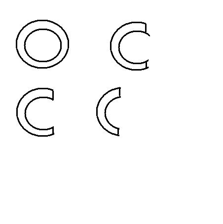

how about i make it like this and stack it on top of each other. then i can use resin to fill in the gaps. finally sanding it down to a smooth finish.
the first ring would be with a 3/4 mdf and the rest would be with something thinner.

seems like a good idea to me. give it a try.

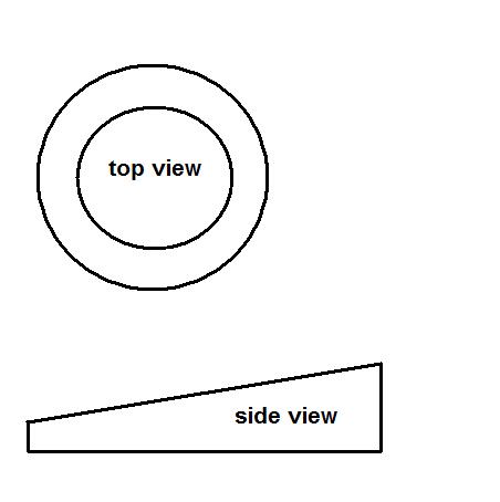

that pic is a side view 2 Mdf Rings a little piece of MDF to give you the angle you want
Then i would get a Can or some cylindrical object same I.D (inner dia) as the O.D. (outer dia) as the MDF so it can slip over the mdf and seal it up there you go
