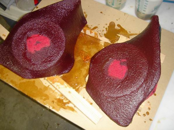

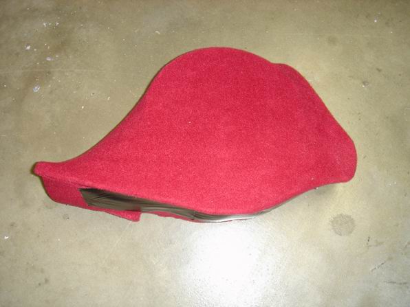

alright got alot done today. so here it goes. pictures and descriptions. lol.

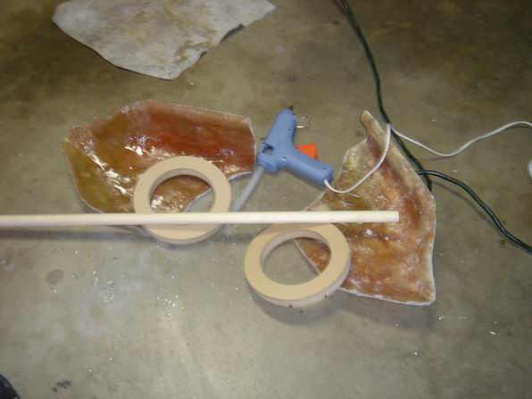

first i laid out all the stuff i am going to be using.

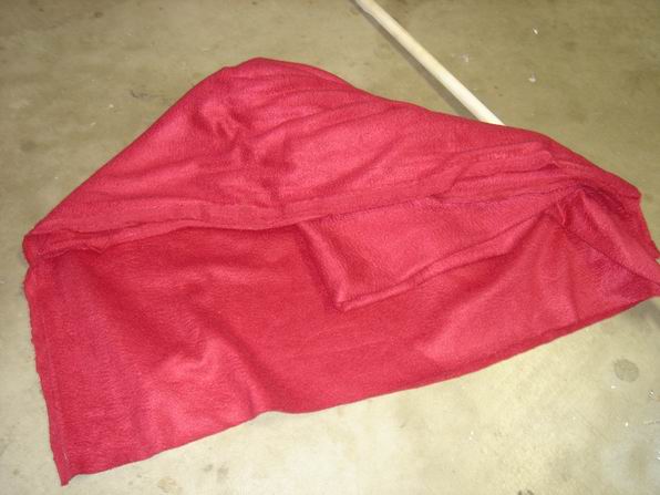

polyester fleece i bought from the fabric store. it works great with polyester resin.

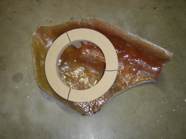

now i position the mdf ring in place using bars and hot glue gun. the hot glue gun works great in this situation. since the floor of the pod isn't perfect flat, the hot glue will ooze in to the gaps.

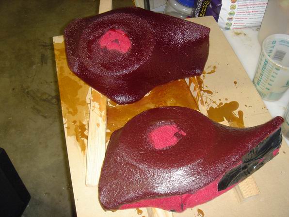

now i wrap the fleece over the ring. i use spray glue on the backside of the pod and stick the fleece on it. then i pull it tight and spray glue on the other side to hold it in place.
finally i mix up some resin and start applying to the fleece. i only apply up to the edges. i don't want to resin the back side. once it cures, i will cut the excess fabric out with a knife.
i still need to sand it and apply some duraglass and body filler to make it as perfect as possible. alots of sanding to do. once that is all done, i will wrap it with black vinyl to match the rest of the door panel.
stay tuned for part 3.......

nice Chad, the shape does indeed look perfect. Your learning very well. How much did the fleece take up? did it take up more than 12oz of resin each pod?
Http://www.rdaudio.net...
Post Number: 19308
12oz was perfect berny. i just went to the garage to check up on it and its already curing. still giving off heat so its not complete but its getting there. it is hard as a rock. lol.

the only negative i have is you should have beveled the rings so you did not have a harsh edge..
looking good tho :-)

the edges on my pods were rounded to make the edge smooth.. only thing i skipped on was sanding them completely so when the vinyl went on it looked kind of tacky.. was in a hurry to have them in for the show that weekend and well when you rush things they don't come out as well
my pods were mediocre.. i half@ssed em and got what i put into them.. overall its a good learning experience..
take your time and do things right the first time.. never rush lol

He can fix the edge you're talking about with filler though. I guess he could have saved himself some time had they been beveled to begin with.
Post Number: 19313
kevin its okay the edges are like that. the mid grill is 6 inches in diameter and goes right along the edge. so when the speaker is on, you won't even see the edge. i purpose made the speaker like that rather than flush mounting it so it will match the woofer that is mounted on the outside of the door panel as well.
wait til you see the finished product.

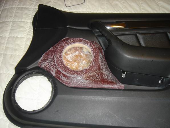

Post Number: 19337
what do you think guys? i think its a real good fit. just imagine the pod wrapped in black vinyl. it will look sweet.

i have a newb question for yA CHAD. since i know nothing of fiberglassing and what not, but how do you get the pod on the door permentantly? screw it from the inside? glue?

hunter, i have pre-drilled 3 holes. one for the cable and the other 2 for the bolts. it will bolt on to the panel. also i will put a 2 sided tape along side the bottom where it meets the pockets on my panel. that will hold it in place.
marc, i have a mmats 3 way. the pod is for the mid. the woofer will go on my stock location and the tweeters will go on my sail.

i am done for now until i get to berny's on sunday. then we gonna use body filler to smooth everything out so i can cover it with vinyl.
in the meantime, i am dying to hear how it sounds so ima just mount it as is tomorow night. that way i can listen to it until the weekend. by sunday or monday, i will have it all done. in fact gonna go buy some vinyl this weekend.

Hey Chad what drivers are going in there 5 1/4's? It looks kinda shallow to me.. Polo.
Post Number: 19343
yeah. its not that shallow polo. before i wrap it, i put the speaker in there to see. plenty of clearence. its a lot deeper than it appears in the picture.
