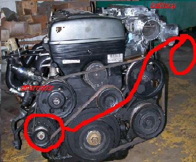

Username: Ska
Post Number: 687
this is where my alt is
Username: Stateprop486
PA
Post Number: 1083
oic..u have the LExus SC300 rite? it looks like u gotta go under ur car then...

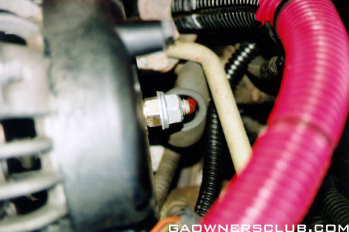

Username: Chaunb3400
All he does is catch t..., Alabama
U.S.
Post Number: 14049
u can see it here..that bolt with the wire coming from it...
