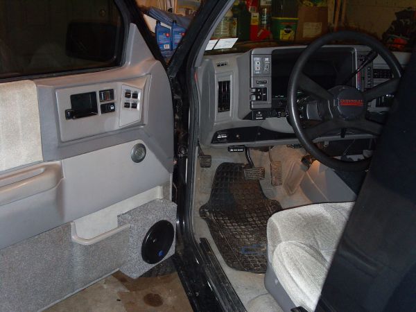

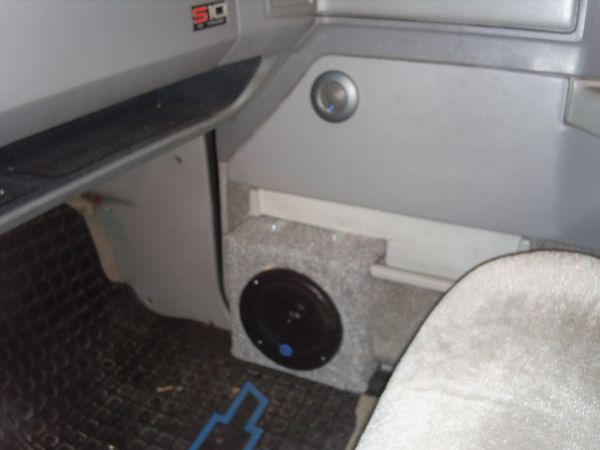

It's damn near impossible to completely seal a door well......... even then, it would be way too much airspace for a little 5.25" or 6.5" speaker. A real enclosure designed for the speaker should make the difference.
If you're lucky there may be enough space for it inside the door. If not, surface mount. For example:
^^^^^^^ Mine
That is done completely from scratch BTW, the truck had no speakers in the doors to begin with.

wow awesome work there MS!
Username: Nd4spd18
Northwest PA
Post Number: 6485
Thanks :-)
