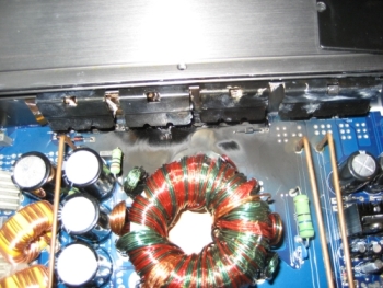

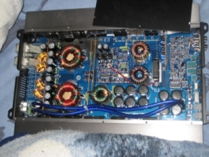

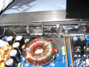

Eh, I went strait to opening up the amp and found that two small black things on the side of the amp are broken. What tey are, I have no idea but i'll post pics soon.
Username: Nd4spd18
Northwest PA
Post Number: 6448
If they're on the side, off the board those would be FETs, one of the most common compoents to blow when an amp blows.
Keep in mind, usually there is more damage than what you can actually see visually.

And M.S., is it worth getting these "FET's" fixed? Or should I look into a new amp?

Like I said there is often more damage than can be seen.......... IDK how much you paid for the amp, but I wouldn't pay to get it fixed, I'd just buy a good quality amp.
