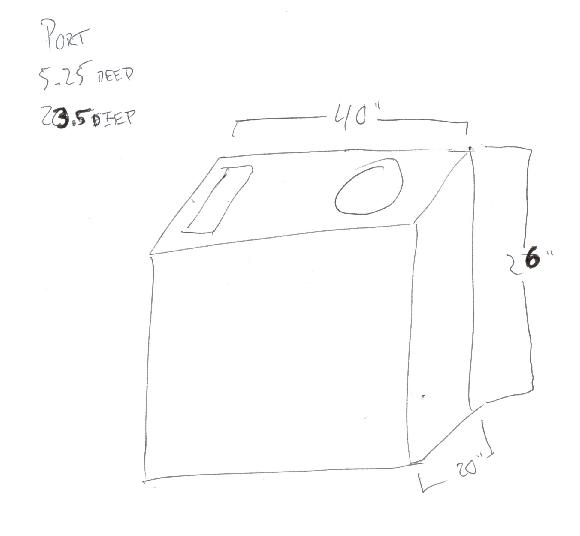

Does this look good?
going for 8.2-8.25^3 ft and 28hz.

going in an SUV?
looks good, i don't think it should be 26*20 i think those should be flipped if possible

its going to go in the back of an extended cab canyon. 20" will put it touching the back of the front seat so it will hold it in place but it wont be able to go any deeper

Post Number: 506
oh ok, i didn't know it was going in the back of a truck, that looks good then, i only said flip those two because if it was going in an SUV the CPG would be higher and it would fall easier

thats why we made it touch the seats. good looking out though man. Gonna start it tonight. Pics hopefully

Post Number: 2187
what do you mean dave? the drawing or the actual palns?

the drawing lol
other then that im assuming you did all your math right??should be fine.

i installed an 18 btl in my ext ranger i used 21in on the face and that was really close to the edges you may wanna rethink that. just my 2 cents
Username: Surferdude9371
Im BTL Bumpin
Post Number: 694
also 20in is gonna have him hugging the steering wheel if its anywhere near same size as my truck

Of course I did the math dave. Im not a lazy b/\stard like you. lol
Thanks for the heads up p. rick. I will wait until the sub gets here to cut the hole. If we have to, I will do it facing the front. Thanks for saving that one. haha

BTW, I got everything but the sides cut out tonight. Should finish everything sunday when I get back in town
