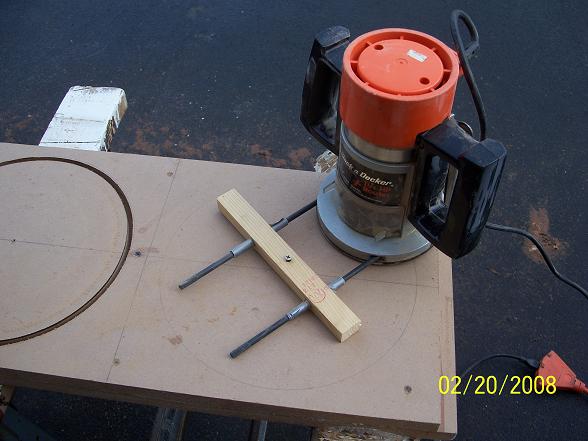

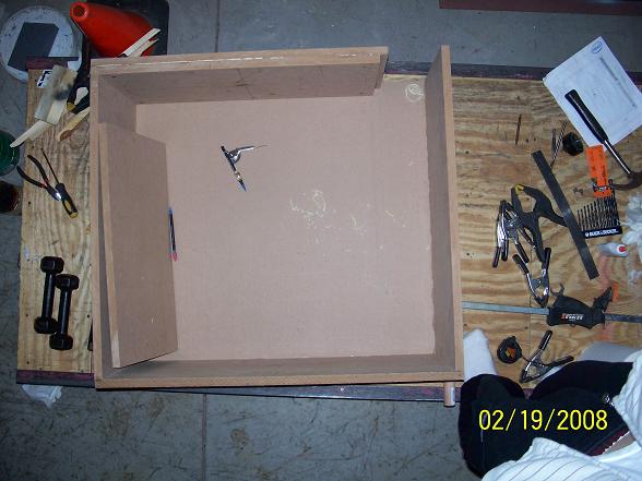

this is where i got tonight. its very cold out and i didnt feel like going back out to cut the circles with the router. so tommrow i shall do that and finish her up.

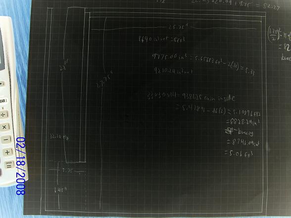

Plans(inverted color showed up better)

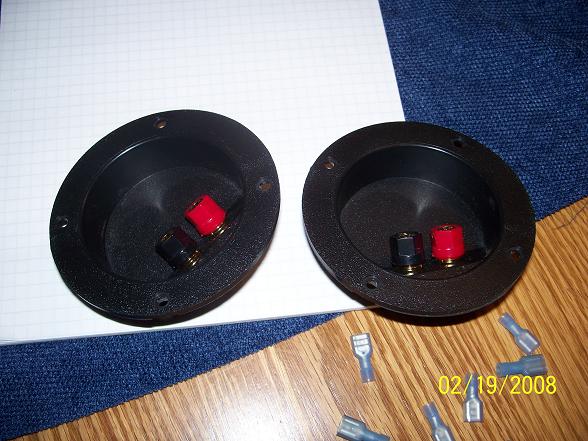

Terminal cups i am thinking of using

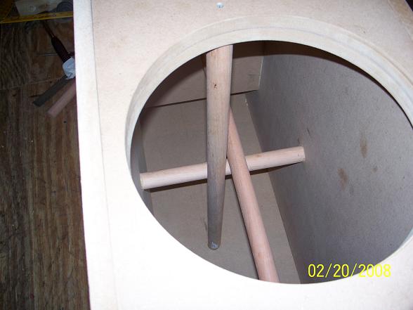

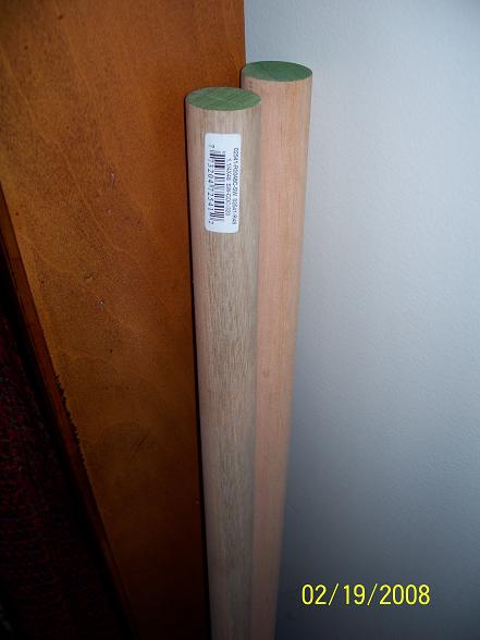

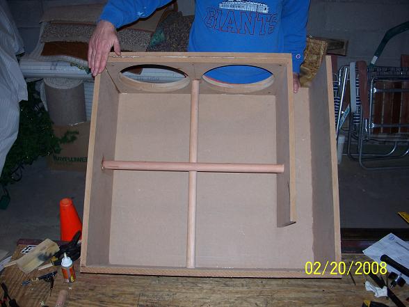

1.25" dowel for bracing

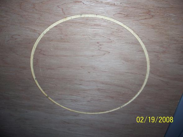

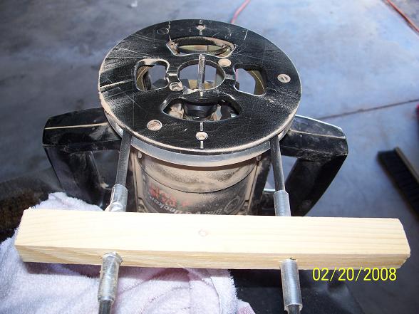

Circle jig test

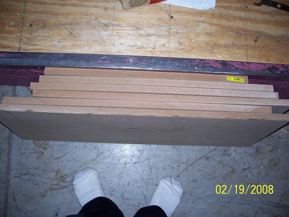

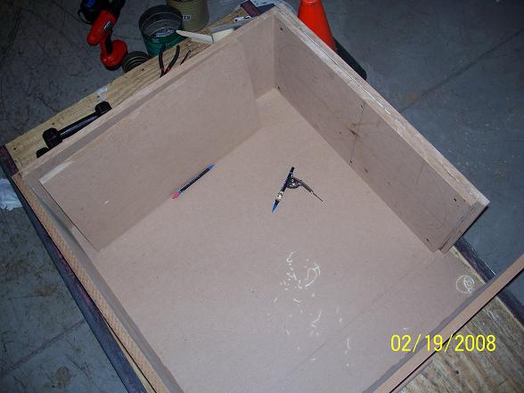

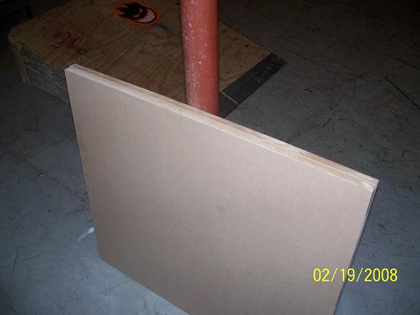

all of the peices that fit between the top and bottom

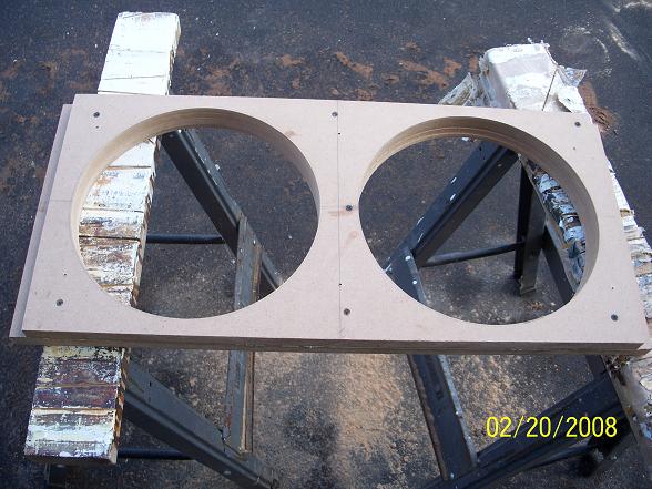

the top and bottom

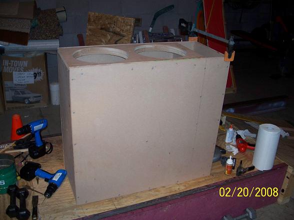

Progress as of tonight(front baffel is not connected yet just balanced)
should be done with construction tommrow then i will mostlikely try to cover her with vinal. any tips or instructions on doing so?

when i did al my cuts it was about 20. when the time came to cut the holes it was about 11.

you can use the terminal cups but you dont need too ...I like the idea of just wires through the box now (not through the port ever thats just lazy and looks bad)... no small connections to mess with that way... plus you dont have to spend money on buying terminal cups

Terminal cups suck :-(

i like terminal cups. very convinient. i have the banana plugs too. lol.

Terminal cups add resistance on the line and sometimes they leak. I would never use them. Nothing beats a direct wire connection.

true that rob. but i used a terminal cup on my new box for convinience. i used that foam tape stuff and lined it before i installed it. also since i am only running 1000wrms i felt that it was ok. when i used to run more power, i would just run the cables straight.

these cups already have foam gaskets and will also be gorilla glued and caulked the ensure no leaks. only reason im considering them is cus i got them for free. turns out i know someone who works at the stereo shop lol.

im actually done with the construction. i just gotta sand it, paint in the port and then cover it all up. ill post pics in a minuite
Username: Mendonmafia
Post Number: 1264

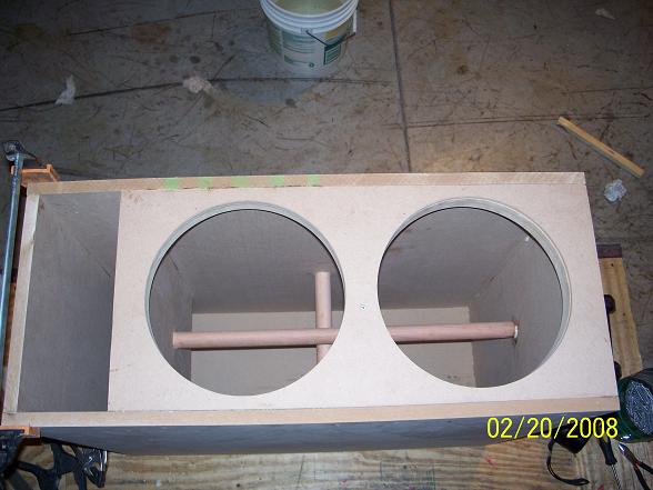

Here they are. let me know what you think.
Home made circle jig works awesome
see what i mean
1.25" dowel braces

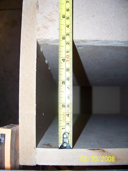

port came up an 1/8" short but that only equates to 1.5 sqin small. i still got 61 inches of port

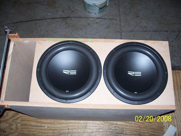

SX's have a nice large home now!

on the terminal cup thing.. anytime ive used them after i put them in and soldered on the wires.. i fiberglassed right over it.. wires won't come off and it won't leak or become a weak spot in the box..
just a lotta trouble vs just using bolts or running wires direct :-)
