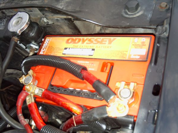

Username: Nd4spd18
Northwest PA
Post Number: 6358
You will find a way to make everything fit...... how many wires can you have........
Heres mine with dual terminals:
The factory wiring is on the side terminals. On the top terminals there are: power wire for component amp, power and ground wires for sub amp, and + and - big 3 wires.
