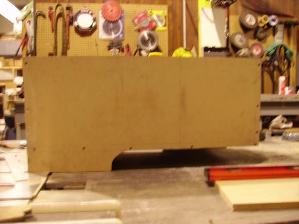

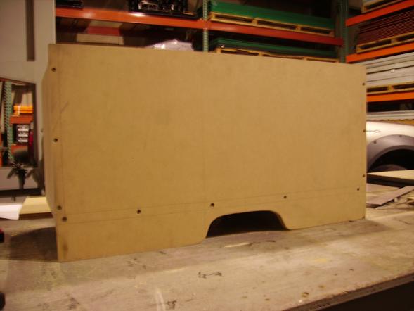

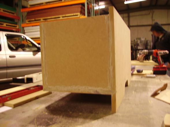

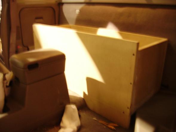

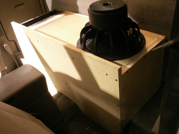

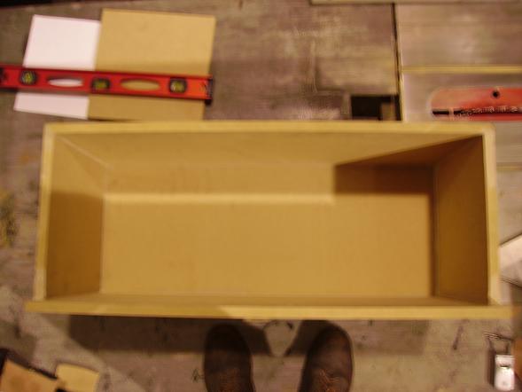

Started it tonight. It is 2.45cu ft tuned to 32hz. The sub will be inverted behind the drivers seat and obviously the port will be behind the passenger. I'm thinking about a flared port but I'm not sure yet... Here are pics
I'm going to work on it tomorrow and hopefully get it put together

Lookin good. What sub is going in this?

12" AA Arsenal. I havent had bump in about a year so I am DYING to get this in!

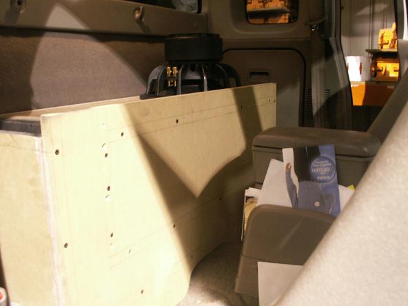

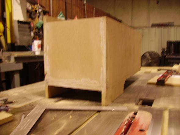

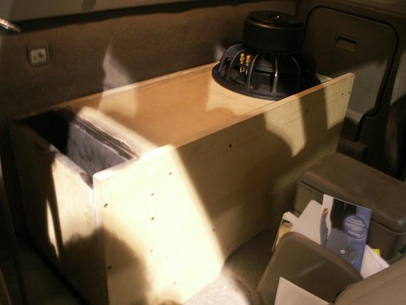

I finished tonight!! More pics. All I am waiting for is the amp to get here and it will be up and running. I will carpet it later, right now I'm a broke mofo plus, I'm adding on a little something to it next week...

why is the speaker up side down in the box? they box really looks good.

one, its upside down to save airspace, two, it just looks better IMO

What are the benefits of inverted and won't the wires coming from the VC's make it look "un clean"?

With the sub inverted it wont be taking up airspace inside the box therefor I can build it a little smaller, which is what I needed in the truck. Also, I bought wires to hook up to the VC so it doesnt look tacky. They are not plain looking ones. As long as I try and make it look good, it will.
