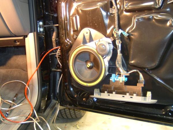

The dealer I auditioned at was a local so cal dealer where I live but once I decided on what I wanted I actually did buy the CDT's at woofers etc.
During the install I modified the frame to hold both the mid-woofer and the tweeter:
Also i agree that with comps the tweetwer should be placed very close to the woofer for best sound. I have all my comps close together. My upstage kit is the exception and is mounted on my dash aimed at my windshield.

lookin good chuck!

hey i always believe that buying a set of component is for separating the mids and highs like atleast 1 feet from one another, i mean thats why its a comp and not coax, seriously though correct me if im wrong, and this goes out to all audiophiles.......

Depends on installation and pieces. If your woofer is in the bottom of the door, you don't really want the tweeter all the way down with. Some sets play better off axis than others. Good general rule of thumb is to keep the tweeter within about 6" pf the woofer.

It is ideal to have the tweeter as close to the midrange as possible. Problem is, if you have the mid in the bottom of the door, you don't want the tweeter that low as it will sound like the music is coming from the floor.
Then you have to mount it higher, and compromise a little.

Sorry, I drive a Miata so my coax setup on the lower door doesn't present a basement soundtstage because the angle "looking down" isn't that great compared to many other cars.
As far as distance between drivers, the closer the tweeter and mid-bass are, the better, because driver integration problems (there are many) are minimized. As a few, including myself have mentioned, pick the set of compromises you can live with. If you are expecting audiophile perfection in a car audio environment, you'd have to tear apart the car interior, spend $$$$$$ and maybe get to 80% of perfect.
