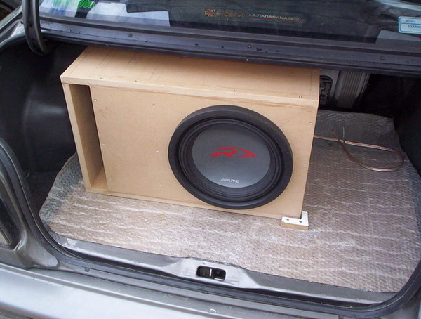

For about three months i have a typer 12" (2+2ohm) with this amp:
http://ampguts.realmofexcursion.com/SinusLive_SL_A-1500/
wired at 4ohm (550w).
This is my box:
2cf at 32Hz.
The gain was set correctly with a dimm with volume at 25/35 and sub out at 12/15 (i have alpine 9812).
Yesterday, i set the sub out volume from 12/15 to 8/15 and wired the sub at 1ohm. Now it is fairly louder, but i'm worring about giving too many watts to the sub (i beleive around 1000 clean watts).
If you were me, what would you do?
(Thanks and sorry for my English :-))

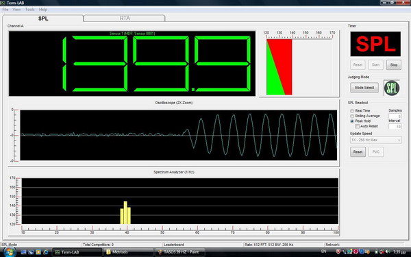

Yesterday i went to a friend and i metered my car with a termlab.
The number is very impressive!
139.9 at 39Hz!! I didn't expect so much!
Here is the foto:
car: nissan sunny '89 sedan 4D
no electric upgrades
sub: alpine typer 1222d
box: 2cf at 32Hz
amp: sinus sla 1500 (1500w - 1ohm)
HU: alpine 9812rb
engine on at 2000rpm, doors windows closed, sensor on the dash
Username: Big_edge_head
Milwaukee, Wisconsin
MY SUB...
Post Number: 1188
very nice. nice box too.

Thats pretty sweet. How much power do you think you were running to it when it hit 139.9?
Username: Paogr
Athens
Greece
Post Number: 162
Registered: Dec-05
To tell you the truth i don't know.
I have set the gain as this link says:
http://www.subwoofertools.com/forum/setgain.asp
with volume 25/35 and sub out 10/15.
With these settings i was playing a soundstream T5-15. One day while i was listening to a bass song (Gimmie That (Produced By Drumma Boy)) i turned the volume at 30/35 and after a minute i smell something from the sub and i turned the volume down.
So i beleive that the amp puts the max clean power with volume 25/35 and sub out at 10/15 (when i have it at 1ohm).
Now with the typer i had the volume at 25/35, sub out 8/15 and i played a sweep 100 to 20Hz to see where it puts out the max db. It hit 139.1 at 39Hz.
Then i played a 39Hz tone and it hit 139.6. After that i set the sub out at 12/15. Result: 139.8
Then volume 28/35 sub out 15/15 and it hit the best result 139.9. At the end i turned the volume all the way up at 35/35 but it didn't give me better number..
I think i was running thes sub with over 1kw. What do you think?
*LPF was at 160Hz and subsonic at 25-26Hz, voltage 12.6-12.7v
