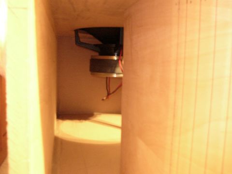

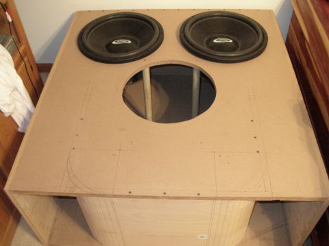

The design above is one way i have been considering of building my next box. But my only problem is that when you look through the 2 ports you can see the magnets on the 2 back subs. My question is... Would it be ok that you can see the magnets or should i put my port on the bottom of the box instead of the sides?
The box is 39" wide x 40" deep x 15.5" tall (inside dimensions). Both of the ports are 6.5" wide x 14" deep x 15.5" tall. The box is tuned to 40 hz

From what I know there will be more port velocity and noise if woofer is closer to port but basically it depends on what you are looking for.. SPL??? SQ????? Vehicle,subs,power????????

Sinful Systems- I am going for SPL and its going to go into a 07 Toyota Matrix each sub will be receiving about 1200 watts rms
jesse- thats a veiw from the top of the box. the inside lines you cant see from the top but i was trying to show where the ports are located i will try and take pics in a few

Oh crap, I should have read your entire post because 40hz is most likely for SPL.... I would say its ok because with SPL you will want the port velocity over the better SQ. Try it the way you have it... JMO

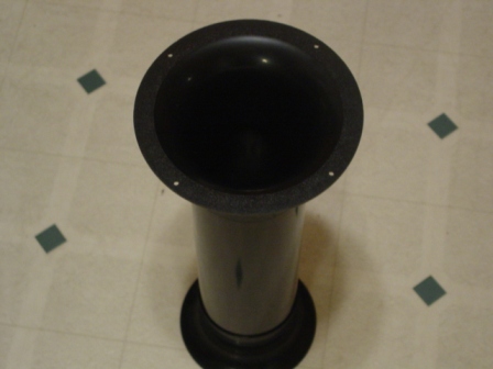

Another thing you might want to try is a flared port like this one...Upload
They say if used correctly you can gain 3db over slot port...

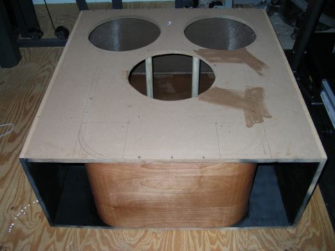

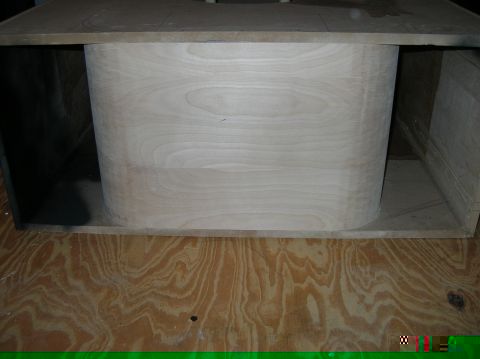

Here you go guys this will hopefully look a little better and make a little more sense
Username: Sinful_systems70
15 INCH WANG...
Post Number: 1058
Looks good, I would leave it unless you decide to go with flared ports.. JMO
Username: Turnmat
Racine, Wi
Post Number: 538
I was considering using the flared port like you showed but i would need over 8 6" x 17" ports like that. And as for one long port at the base thats what i am trying to figure out. Right now i might just do it that way...
Username: Mgbcs
Lincoln, Nebraska
Post Number: 1952
Looks great. Why are you asking these questions now after you have a beautiful box made?

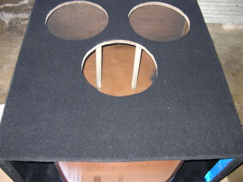

do you think being able to see the magnets look kinda crappy?

I think it looks kinda bad a** seeing the magnets.

How did you figure on 8???? Most people say the 6" are too big because the opening gets to almost 9"... You might need less than you think.... I'm not sure... What is the cuft of this enclosure minus the speaker displacement and I will try to figure it out....

BCS i am asking cause i built the box and then noticed that you could see the magnets...mistake on my part

I figured on 8 because DJ Langford told me that i would need 5 6" x 17" for 2 of the HD3 15's
the box is 13.5 cuft. I am not sure how much the HD motors displace i think its like .22 cuft so i would say probably 12.84 cuft after displacment...

I just did my calculation and you can use (4) 6" flared pots each 10.72" long... Not sure if thats correct but the calculator I have for flared ports indicates this....

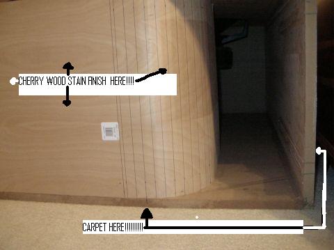

Basically carpet all around and stain the wood after removing the lines and UPC sticker. That would look sweet!!!!Mask the bent wood and paint the port!!! Just a suggestion, but it would look good!
Username: Turnmat
Racine, Wi
Post Number: 556
I was going to carpet it like you said and either paint the port and do a cherry finish like you said or i was going to paint the port and paint the front the same color as my car. Not sure if i will have it all carpeted by than or not.

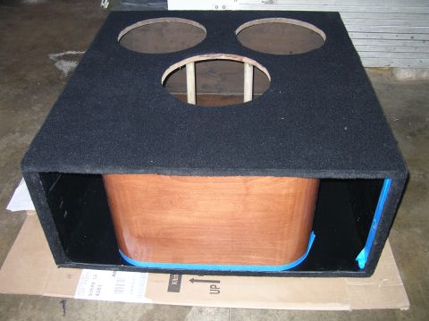

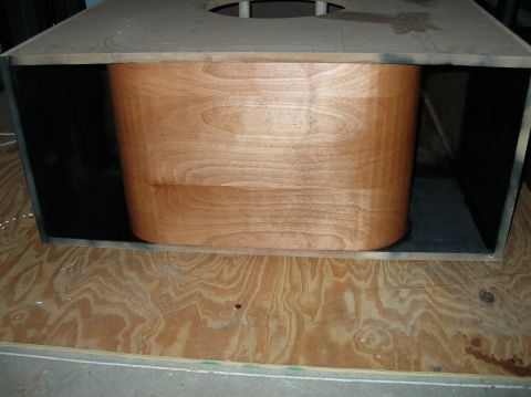

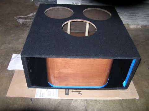

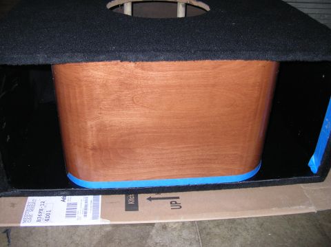

Oh yea...i am in the middle of sealing the box and painting the port as well as taking care of the upc and sanding out the lines. I will try to post some pics later tonight
Username: Turnmat
Racine, Wi
Post Number: 572

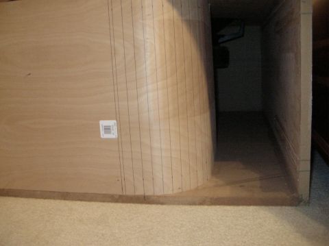

Taking and sanding those lines off was a pain in the @ss. I had to do it by hand cause we dont have a sander...took me 1.5 hours

Thats why I use pencil and erase!!!! I would say on the 19th or the 26th. Which ever fits best into your schedule... Let me know... Any pics yet????

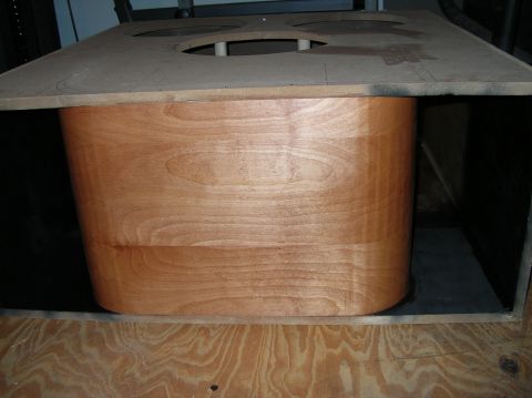

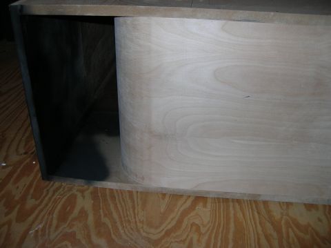

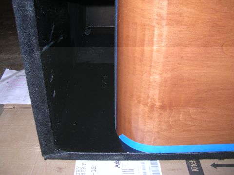

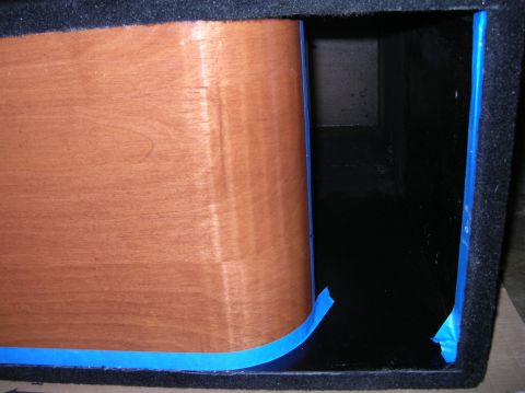

Yea i made the mistake of using pen. I will post pics in the morning. I didnt get a chance to and i am at work at the moment.
Username: Turnmat
Racine, Wi
Post Number: 575
The first pic is the port with the lines sanded off
In the second pic you can see i started to paint the one port on the left side and on the right side you can see the inside of the box where it was sealed

whats wrong wth the box design?
Username: Turnmat
Racine, Wi
Post Number: 581
I finally got some time to get some new pics up with the box being stained. Now i just need to varnish it and then its on to carpet
15 INCH WANG...
Post Number: 1149
looking good!!!!

here you go guys i finally got the chance to get the pics loaded. Enjoy!!!
15 INCH WANG...
Post Number: 1234
Told you!!!! NICE!!!!!!!!!!! FTW!!!!!!!!!
Username: Turnmat
Racine, Wi
Post Number: 598
My carpet job isnt the best but it looks prettty good i think. It was a b!tch to wrap the carpet onto the 3/4 part by the ports
