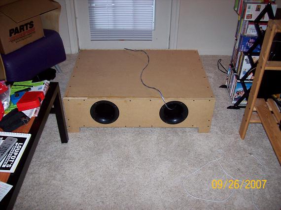

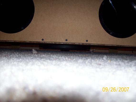

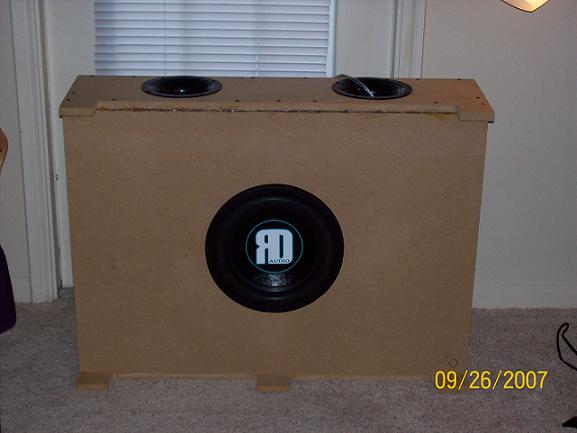

here is my down firing 3 cubes, single 12"
