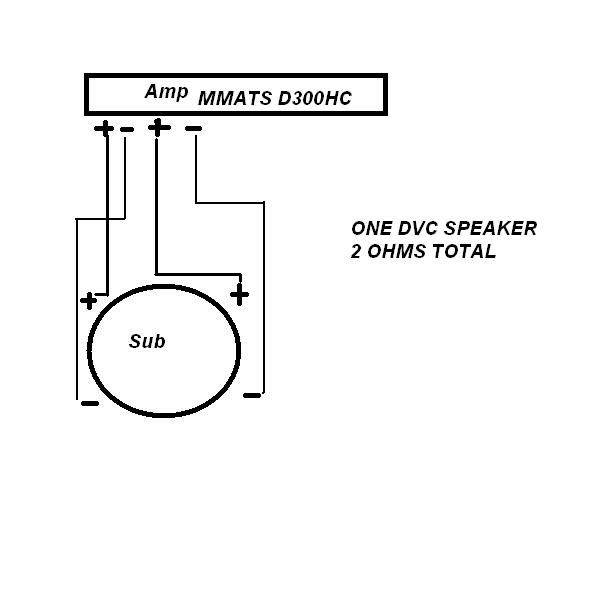

I have a matts d300hc class d amp it has two negative and positive speaker connection terminals, so now how do i wire my dd3515 sub to 2 ohm load on the amp? it's confusing me because the paper work says "single DVC speaker 2 ohm load" and shows a picture with a woofer and both the positive and negative on the woofer wires going into its own negative and positive on to the amp (which has 2 of each again} I though it should only be wired to 2 ohms inside the box to the wire out terminal to one negative and positive on the amp.
UPDATE: wired to 2 ohms inside the box but it barely hits wtf? then i did it like paper it came with showing this and hits a lil harder but not 1200 watts at 2 ohms at all and the speaker wire terminal is super small like for remote wire size what can be wrong? need help fast work soon!
THE PICTURE LOOKS LIKE THIS

what ohm is your sub? dual 2 or dual 4?
Username: Torn
Post Number: 224
Registered: Jan-07
dual 4
Username: Jakeyplaysbass
ASU
Post Number: 2028
amp - to sub - to other sub -
amp + to sub + to other sub+
u have it right in the picture but only use one + and one - on the amp, not both.

wtf? do this. wire (inside the box) pos to pos, neg to neg on the woofer then take the pos rom one side of the sub and run to the amp. then take the neg on the opp. side of the woofer (side that doesn have the pos wire goin to amp) and run it to the amp. BUT bridge the amp.... tak the pos wire from the woofer and put it on the left channe pos and then take the neg side and hook it up to the right channel neg. there you go.

i did that but it barely bumps, is something wrong with the amp you think?

you wired it like in the pic or the way i decribed it? and check all your amps settings. gain, lpf, ssf

i wired it like you described it and now it's wired like the pic and hit a lil better but not bumping close to 600 or 1200 watts at 2 ohm.

It looks as though you've got it wired correctly.
