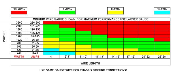

Ok so i have a 1 Cerwin Vega Stroker-102 10" 4000 Watts Dual 2ohm voice coil. I have a ported box tuned to my specifications. and i have a Massive Audio P1500.1 1ohm amp. max 3000 watts. first of all, are these good?
what guage wires should i use?
when i hook this up to my car, will everything be fine, will my alternator blow, or should i get a capacitor?
and to hook up my sub to my box it didnt come with wires... is their any specific size/kind of wires i need for that?
any help would be greatly appreciated... thanks!

and one more question. my car has a 105amp alternator... will i need a bigger alt? and does it only use more amps when i turn it up louder?

First of all that sub can only take 2000w rms, and the amp 1500w rms.
Typically at anything above 1000w you should upgrade your alt.
