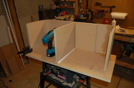

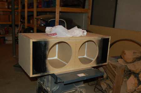

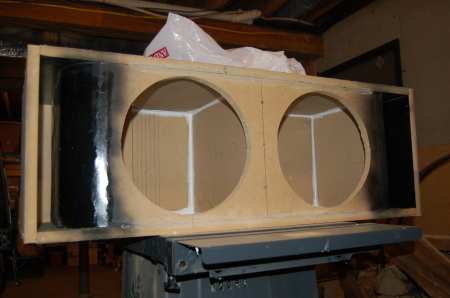

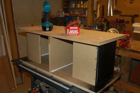

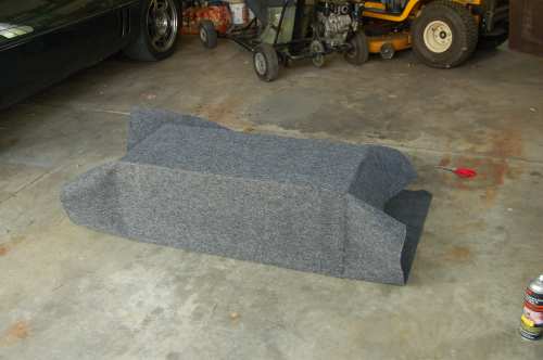

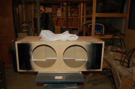

11am-10pm today... Im getting carpet first thing tomorrow morning, and cutting the circles and posting the back on. I'll post more pix tomorrow. Let me know what you think.

was that ur first attempt at a flared port?
Username: Jblanford
Post Number: 1145
specs/tuning ? whats it for ?

Looks like a HT box. For only his fourth box if I remember right, this kid got some skillz. Nice job.

"was that ur first attempt at a flared port?"
Yes it was, When attempting to do the curve first time around, the board broke in half. Second time, I recut the board the same as before, but pre-bent each slot so it flexed better, then soaked in my pool for 10 minutes slot side down, and it worked perfectly!
"specs/tuning ? whats it for ?"
3.5 cubic feet tuned to 35HZ based on a squared off port, so its a tad different due to the curves, but around 35Hz.
"Looks like a HT box. For only his fourth box if I remember right, this kid got some skillz. Nice job."
HT box? Thanks man, I appreciate the comments.

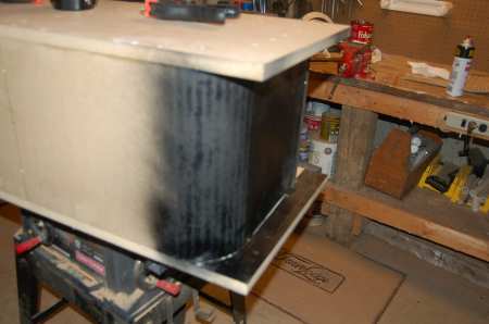

You better resin those bends or do something.

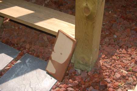

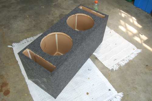

HT = Home Theater. What Logan is saying is that it looks like you cut pretty deep on those bends so you need to reinforce it with some resin so they don't pop under stress. It looks like he put something on one of the bends in pic #4.

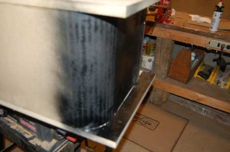

oh lol no pic 4 is the water from my pool. I globbed on some glue and sealed it up real well. Its not gonna break under stress now, if it was gonna break, Im sure it would have already at least cracked significantly. Thanks tho for suggestions.

you put it in the pool!!! yikes, that is going to compromise the strength in the wood.

Just the slots, it worked wonders, and dried out in ten minutes. The wood was easier to bend and the strength of the wood was not sacrificed. TRUST ME!

Bad new's! Water and MDF do not play well together!!! Time to get a couple gallons of resin and some fiberglass fabric do it inside and out!

John, dispite what you believe. Soaking your MDF in water WILL mess with the strength. It will cause the MDF to swell and will become very soft. You will probably want to rebuild that.

But the sound will be significantly different because the MDF was soaked in water for 10 and completely dried in 10 right? NOT!
The MDF cracked because it was soaked in water right? NOT!
Its fine quit hatin.

it worked for me. The MDF was a tad softer at first, but after 10 minutes I forgot which piece was soaked in the pool. It's like basket weaving.. You gotta soak it before ya bend it. Im sure there are otherways to do it, I just choose water and am 100% satisfied with the results and I bet if anyone felt the wood, they too would be clueless it was soaked in the pool.

John thats fine.You have a hard time taking peoples advice, dont you. There are some very knowledgable people out there. If your not willing to take peoples advice/tips you will have a hard time building correctly. When I was first starting to build, I learned MANY things from people over at CA.com. Things I would have never done/used etc. If your willing to learn a few things, you will be better off.
And one last time, water is not good with MDF. Trust me

water swells MDF and weakends the bonds fact.
and i have done a few flared slot ports and have never had the wood break in half or needed to soak it in water. if you make the cuts right it will bend with gental force.
im not trying to be a d;ck we are trying to give you advice but because you relized your wrong you get all worked up about it. take it like a man and build another one like everyone else.

Water may swell MDF and weaken the bonds overtime with constant exposure to elements, but i said ten minutes slot side down is how long it was exposed to the water. It will be in a trunk, not a backyard... My MDF didnt swell or like fisher said, turn soft. If it worked fine for me and there is absolutly nothing wrong with it physically, then why make a big deal about it? Your getting worked up, and im not gonna build another box and put this one out to the road, when it is identical to a box not soaked in water. You just dont realize this, and if I could get better details through the internet I would and proove every single one of you wrong.

http://www.allwoodwork.com/article/woodwork/methods_of_bending_wood.htm
Steam Bending Wood
Steam bending wood is probably the most widely used and accepted method of wood bending. It has been used for ages
To construct a steam box you will need.
• A heat source to make to steam
• A container to hold the water to be heated
• A hose to connect the container to the steam box
• A box to hold the wood to be steamed. Can be either a PVC pipe or a wood box.
• Various fittings, clamps, and screws to put the steam box together.
The heat source can be a camp stove, or just a hot plate. Open flames in a wood shop can be dangerous, so I would prefer a hot plate.
The container to hold the water can be anything you want. A tea kettle works well, but some people use NEW and UNUSED metal gas cans, pressure cookers, etc. You have to be able to attach a hose to it somehow, with fittings and such.
The steam box itself can be made from PVC pipe, metal pipe, or a simple wooden box you make from scraps in the shop. It don’t really matter that much. Steam has to be able to escape, or else the pressure will build and cause it to explode. But you want it to hold the steam enough to heat the wood and force water vapors into the wood. Roy Underhill from the Woodwright’s Shop uses a wad of rags to plug the end of the box, and you can see the water dripping out of the end. If you use a PVC end cap, drill a hole or two in the end to allow the steam to release to pressure as it builds.
Now just assemble everything and try it out. Be careful the steam will heat everything up, so use gloves. The general rule of time is about 1 hour for every inch of thickness being steamed. Use this as a starting point, and adjust your time as needed.

LOL. Steam = water. That article suggests that steam is an effective method for bending wood. Since steam is a form of water and that method works, I guess you can say this is an article 'halfway' backing my method. Thx Sean.
I better put this so Fisher doesnt come back with a page in a half argument. I know this is not the way I did it, but your argument was that water weakens and softens the wood. If this were the case and water truly doesnt work, I wouldnt have an affective box, or this article wouldn't have been written.

Well I did some more reading and others dont recommend using water to bend mdf just plywood but ill say this if you say it works for you and you teted the strength and appearance we can either take your word or try it ourselves

http://www.rockfordfosgate.com/forum/topic.asp?ARCHIVE=true&TOPIC_ID=19916
conflicting report
A friend of mine is a cabinet maker, They use steam and the slits you refered to to bend MDF sheets, He made a bar that ran along the back of a room and along two other walls and that had a massive amount of bent sheets, But he was telling me they buy a special sort of MDF thats been designed to bend using steam.

Hey John, it is a nice looking box! Did you have a computer to figure dimensions and porting? Doing the flared ports it is nice to have software to figure air space and vent. The cu.ft. inside can be - .2 to .05 difference per side depending on the radius compared to 90 angle. The same with the vent you have to caculate to start of flare instead of end of flare. here are a couple things I found for you.
How large a flare is needed?
I have conducted a series of experiments to determine what velocity of air can be passed through flared ports before port noise becomes audible. Fifteen ports in a range of diameters and flare sizes were tested, leading to the following observations:
* Maximum usable velocity varies with flare radius
* There is a limiting velocity for any given diameter port, regardless of flare radius
* Larger diameter ports have a higher usable velocity than smaller ports
* Port performance varies with frequency
The results have been incorporated into the "flare-it" downloadable calculator. It is suitable for designing flares for ports up to 150mm (6 inches) in diameter, and which operate with a velocity peak below about 35hz.
Also did alot of reading about MDF and moisture there is a lot of info about loss of internal bond and exterior thickness increase, and day's to weeks for proper evaporation of moisture,just as why we season firewood it takes time to dry. so if you put any thing on it like paint or sealer, it will not be able to evaporate and dry properly so the internal bond of the mdf will be compromised.. Hope this has helped you. I am not slamming you! it is a good looking box!

Hey Sean good post! lots of info the other MDF has a differant chemical used for bonding the dust, rather than the formaldihyde. and pressure bending is the right way to do it! the steam doesnt absorb like water would, it is more of a heat source. Here is a site about flares http://www.subwoofer-builder.com/port-flares.htm

MeSoDumm, thats all I use, is Trupan Light.
Steam bending is far different that soaking wood in a pool.

Can do paul. I finished the box tonight, all I got left is cutting the holes, and I ordered some carpet from parts express. As for Joey, I'll save her the humiliation.

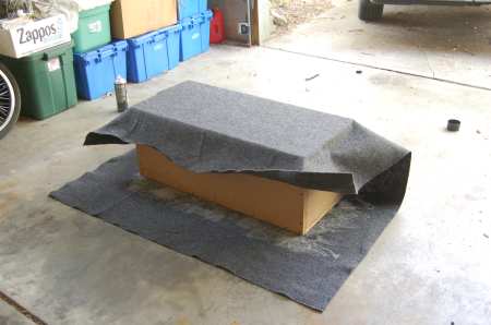

Try taking pics of the carpet process. Alot of ppl are curious as to how everyone does it. When I carpet mine it always seems like an art form, and I'm no artist lol.

When it comes to carpeting, I watched a tutorial, and my mom had good ideas too when it came to getting perfect folds on the end. Its similar to wrapping a present. My mom wall papers a lot and she said the overlaps and the ends are very similar to that, so between that tutorial and my moms guidance, I get that box wrapped ;).
As for JK's question about the chemicals. There arent too many in there now, we just took the cover off and are waiting for things to clear up and then it will be shocked and chlorine tablets will be put in daily. But not many chemicals were in there when I wetted the wood.
ctmike, why do you want to know that box price? I'm not gonna add it up if your just trying to be a smart@ss and proove some point no one cares about.
Username: J_c_wheeler8
Columbus, IN
United States
Post Number: 673
ah and come to think about carpet pix, i took some last time i carpeted my box.. here ill post some
Well i thought i had more, this doesnt give you the best idea, but ill take more this time around.

Nice- water+mdf... here is an idea- take some mdf- throw it in the pool, let it dry... then break it (trust me- it wont be hard) and inspect the inside of the wood.... GUARUNTEED its soggy and sh.itty.. whatever floats your boat, though
Username: Bjfish11
Garden Plain, KS
Post Number: 184
Not to stir this thread up again...but.....
Ok, so I did some testing today... was very curious about this topic. What I did was grab a scrap piece laying around. It was approx. 5" wide x 18" long. I tried breaking it over an end of a table by putting pressure on both ends with the middle of the wood resting on the edge of the table. I gave it 5 good trys but I couldnt break it. Soaked it in a bucket of water for 10 mins. (The whole thing wouldnt go in the bucket, about the first 12" did.) I let it dry for 10 mins (Like the other guy did). It was still soaking. Checked the thickness, and it was thicker, by a hair. Im guessing around 1/32", but was clearly swollen. I waited another hour and a half, until it was completely dry. Checked the thickness again, hadnt changed, was still about 1/32" thicker. Put it back on the table the same way to test the strength, and it snapped on the second try.
I checked the inside of the broken pieces and they felt soft, and tore out very easily.
Columbus, IN
United States
Post Number: 684
Ok first of all, I didnt soak mine in the pool. I laid it very carefully slit side down in the pool, and only about 1/3 of the wood was submerged from the bottom. 10 minutes later, I picked it up careful not to dunk anymore of it in the water. Let it drip off and i leaned it against the table outside for 10 minutes, by that time it was completely dry when i matched it up with the other MDF i had inside, it was identical. I believe since i didnt drench the entire piece of wood in the pool, thats what helped it to dry quicker and not affect it as much as if i held it under water. When I bent this after about a total of 15 minutes since it had been removed from the water, the wood bent much easier, but not too easy, and the wood did not feel soft at all nor did it crack at all.
All im saying is it worked well for me with no signs of water damage.

"Nice- water+mdf... here is an idea- take some mdf- throw it in the pool, let it dry... then break it (trust me- it wont be hard) and inspect the inside of the wood.... GUARUNTEED its soggy and sh.itty.. whatever floats your boat, though"
Never got an email on this comment, but I will try this to try to see where you guys were coming from. I wouldn't say it worked fine if the damn thing fell apart. All i stated above was what I observed. Like any experiment or test, I'm not gonna put what was expected in my conclusion if the complete opposite happened in my case. I'm going to put what I observed. And if i didn't observe everything you guys said happened, im not gonna be like ok, your right, when in reality, this may be the case for some, but for some reason the way i did this it worked differently and better for me.
Columbus, IN
United States
Post Number: 686
I am doing this experiment again, and am taking pictures, I will most certainly post the results.
Columbus, IN
United States
Post Number: 688
Correction on time: Once having done this experiment again, using a clock at 10 minutes, I realize that there was no way I let that wood stay in there for ten minutes, it was only a brief amount of time, and I believe five minutes is more accurate. Nevertheless, I will post the results on ten minutes, and possibly do another experiment with only letting it soak for 5 minutes.
Columbus, IN
United States
Post Number: 689
DRY MDF = 0.759"
WET MDF AFTER 10 MINUTES = 0.791"
Fisher, you were right. This wood did swell and it had a softer texture than the dry MDF. You were also right when you said it didnt dry in ten minutes. I realize when I first explained my process of how I bent the wood, I carelessly threw out a time of ten minutes, after doing this experiment I realize that it wasnt nearly that long, and saying it was 5 minutes, would be a stretch. I wet it enough so that the wood didnt act as as sponge as this piece of wood did.
All I know is that I messed up by saying I soaked it for ten minutes, and by those standards, I would have to agree with you by saying that I was wrong and you were right, the wood swelled, wasnt dry, etc, etc. I also know that when I did this with the actual piece of wood, it didnt swell up or suck in water like a sponge. It was dry after ten minutes, and everything I stood by above.
I apologize for the miscommunication and this once decent thread turned into.. how Paul put it, trainwreck.

...Ok I Finished up the box, sealed up the inside, cut the holes. Now waiting on my order from parts express for my carpet. Im debating on installing terminal cups on this project or not. I have heard mixed reviews of them... Some say they are a possibility for leaking air, others say if you dont, you will leak air.. Hmm...

Hmm.. I cut the holes, carpet the entire box, cut around the terminal cutouts, but what do i use to seal them up? So i silicon all around the edges and then screw them in tight, or what?
A pic is worth
1000 posts!!
Post Number: 6872
Do the cups have screw holes or are they just pressure fit? Usually the carpet acts as a gasket between the terminal and the box and that's generally all you should need. If this was a sealed box I would worry more but as long as you can't see inside the box around the terminal any air loss would be minimal and insignificant.
Columbus, IN
United States
Post Number: 696
they have screw holes.

I cut the holes for the terminal cups with the circular hole cutting thing with a 2" diameter that you put on the end of an electric drill. It worked wonders and I had perfectly smooth and round holes, no problem, except.... After about 30 seconds of constant drilling, the sawdust would turn from light tan, the color of the MDF wood to dark dark brown, and smoke would arise and to say the least, it smelled like sheit! It was the most disgusting smell I can honestly say I have ever smelled. I wanted to puke my guts out! Those circular cutters are about 20 years old, so I may try to get a newer one next time and see if that helps the smell, but I lost my appetite for dinner because of that smell... Any idea what that smell could be or be from?
Username: Bjfish11
Garden Plain, KS
Post Number: 186
Its just the MDF burning. I remember that smell... its terrible. What you need to do, is drill for a little bit, pull the bit completely out, and clean out the teeth, This will help prevent the burning smell.
What I did, was instead of getting the circle cut out ones... get the square cut out ones and just cut your hole with a jig saw.
Columbus, IN
United States
Post Number: 698
Hmm.. Well the reason I did this was cuz it didnt take as long as with the jigsaw and it's more accurate. Do you just use a jigsaw when cutting out your circles for the speakers on your boxes?

Good sharp tools are key. 20 year old anything is probably dull. I have many forstner bit sets that go up tp 3 1/4" wide that work well under low speed. Even decent hole cutting saws work well. Burning is due to over speed and/or dull bits/blades.
A pic is worth
1000 posts!!
Post Number: 6884
When done right a jigsaw works as well as any for your sub hole. Some like routers with the circle jig. Up to you. It doesn't need to be within a tolerance of 1/64th of an inch. It's a box for a speaker, not a NASA project.

As Paul pointed out, new good tools wouldnt definitely help. I just never had much luck with the hole saws. I cut out my sub holes with a router.
I agree, the circle holes look cleaner, but it was such a PITA to me, I chose the square ones instead. Its just a personal preference.

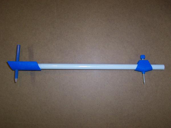

a tip ill throw our for subwoofer hole cutouts would be our trick....take a scrap piece of mdf and after measuring to find the center point where you want your subwoofer drill a small hole and place a screw in it then drill a small hole at the point of the outside diameter of the sub hole and use a writing instrument and simply rotate....a perfect circle is the result ....then use your jigsaw to cut it out
Username: Insearchofbass
Post Number: 5187
"our" should read out

"a tip ill throw our for subwoofer hole cutouts would be our trick....take a scrap piece of mdf and after measuring to find the center point where you want your subwoofer drill a small hole and place a screw in it then drill a small hole at the point of the outside diameter of the sub hole and use a writing instrument and simply rotate....a perfect circle is the result ....then use your jigsaw to cut it out"
Yea, this is what I do..
I measured a piece of hemp exactly the diameter of the cutout, and drill a small hole, put the hemp at the bottom of the drillbit and trace around in a circle (with loops at the end of each end)

I use cardboard in the same manner for circles. Whatever gets the job done

th wood from the mdf works because it doesnt flex or move....not sure what hemp is but im imagining a string type thing an that has a pontential to move on ya

"th wood from the mdf works because it doesnt flex or move....not sure what hemp is but im imagining a string type thing an that has a pontential to move on ya"
The hemp is a type of string, and it worked great for me and made perfect circles. The loops are tied extremely tight and wont go anywhere, the most they may stretch is like maybe 1/64th of an inch, which is completely unnoticable. Like Paul said, this isnt NASA.

This is what I use for large circles. I can get up to a 26" diameter circle. Larger if I just swap out the rod. Push the center pin into the wood and draw. Quite simple, quite cheap. Less than $10.
