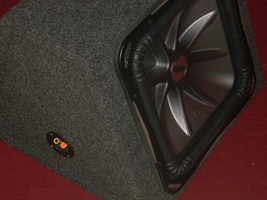

Is the amp massive audio rs 100 2 ohm stable? because i wanna run my single s15l7 06 model with it through 2 ohms right now its at 4 ohms and its in a sealed box. any recomendtions? on box or so on... i was thinking of building my own ported box for it and making it out of fiberboard......

Do not run that amp at 2ohms bridged. Your getting about 1000rms @ 4ohms right now. Thats the best you can do. Build a ported box and that should satisfy you for awhile. Nice amp man.

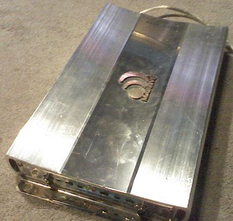

The kicker zx750.1 would be good. I just found out that the RS 100 only does 750rms at 14.4volts. It doesn't do anywhere near 1000rms unless it was given more voltage. A kicker 750.1 would do close to 1000rms, but you will barely notice it. I would first get a box made by logan, and then decide if another amp is necessary or not.

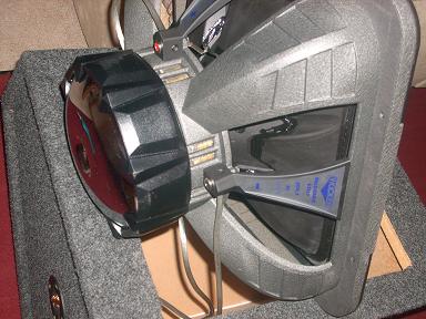

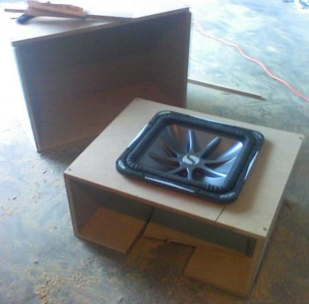

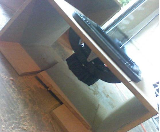

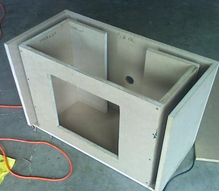

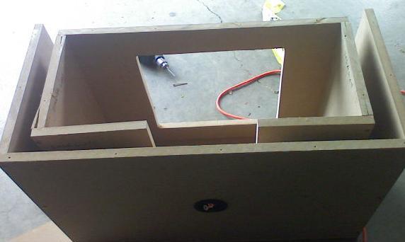

aite here some pics.... i already glued n screw the 5 piece togehter that my sub is sitting on... waiting for it to dry so i can put all of it in tmr when i get home from work.. i thought of the desing my self... and the cut hole size i got it from my old box i just use that measurement and the box size all of it is about 3.4 cubic foot its about 14 inches deep total and 20.5 inches high and 30 inches long i made it so it would have to ports instead of one and the sub would be right in the middle of it instead of having the sub on one side and a hole on the other so i just made each side have a hole and from the sub to the hole is about 6.25 inches apart and from the sub to the bottom is about 2-3 inches around there i for got lol... and the hole is about 2 inches wide on each side and the back is about 1.75 inches away from the back of the box.. cant wait till what it sounds like!!!! and imma carpet it later once everything is all done.. which probably goin to be about a week or so... most is two weeks heres a two pics of the box an the sub which i took earlier....i did my volume according the my sub spec which is for port about 3-6 cubic foot

i used carpenters wood glue and some wood screws for it.... i went out an bought a sheet of MDF for like 24 and told them to cut it up for me so they did all expect for the whole for the sub so i did that myself.... so all was bascially less then 40....

oh and here the amp i use to power it... its the massive audio rs 100Upload

well. how did you know how to design it haha. how do you know what its tuned to.....we'll, hope it works out.

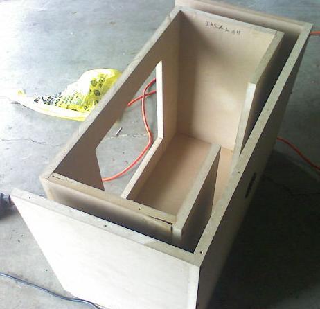

hahaha iono guesstimate? lolz well i just glued it n screwd it together ill find out tmr if it sounds good or not hahaha well here wut it looks without the top piece...

it kinda cracked on me the wood... just the two center piece though good thing it wasnt the other ones... how u think i do for my first speaker box ever???

Lets just hope it works haha. Make sure your port is even thoughout. You'll do better on your second box.
