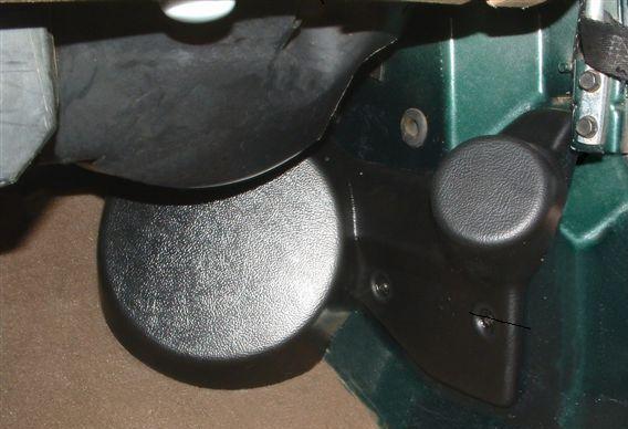

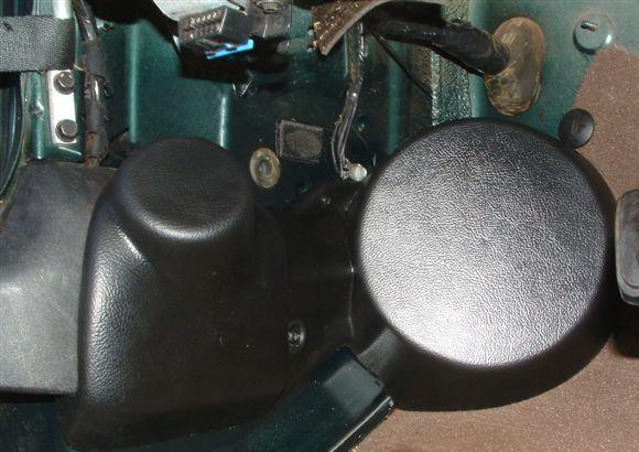

Finaly I got my kick panel pods done! I looked for a quick fix but, I hated the ones I found online and in mags. They put them right inside the doors, Right in the way!!! I made molds to copy as many as needed, the local stereo shop said he would buy them when needed, especially after he saw them. You can see them here on myspace http://www.myspace.com/uroc97tj

they look good what did you use to secure them to the car with?

Thanks! when I molded the fiberglass I put 2 1.5" washers with 0.125 holes, spaced about 2.75" from center of speaker hole front to back and used a self tapping screw. It makes a for a secure tight fit.
