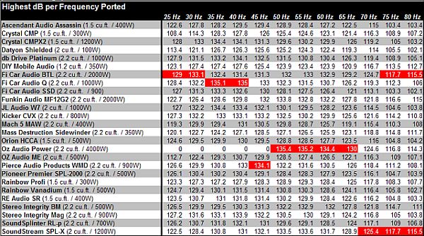

I have a 12" Fi Q (in a low-tuned ported box) which is known to lack in the 60+ hz range, so I was also wondering if my freq range from 60-100 would be horrible if I set them this high. What do you think?

Lacking in the 60+ hz. range compared to what?

Well thanks for the great 12 pic, I didn't even think about that. I guess word of mouth isn't that great as it does good in all freq ranges..
