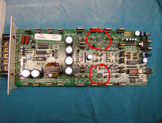

On A Zapco Z100 C2 Compotition amp, there is a left and right bias adjustment.
According to Zapco
"Turn the bias controls fully counterclockwise. No input & no speakers attached. You need a current meter connected between the main power input lead and the amp, apply power and turn unit on. Take a reading from the current meter - should be around an amp of current. Adjust the left bias control slowly, watch the current meter, add 100ma or .1Amp to the original reading. The adjust the right channel bias control, add another 100ma or .1Amp to the reading after adjusting left channel. That should be it.

So what do they do if you turn them up? I have 2 amps, 1 amp had them turned about 3/4 up, the other is about all the way CClockwise down. If these amps were used in comps, what gain would they get by increasing rail voltage? Whould you need higher voltage in order to adjust these? like 17 volt systems?
I plan on adjusting them like Zapco suggests, but am courious as to why they would have that adjustment, and what is it used for.

the bias adjustment just balances the left and right channel input stage of the amplifier.
Don't turn them up beyond the recommended 100mA range, or you'll overdrive the output stage of the amplifier, ad send the amp into clipping, causing audible distortion, and damage to your speakers.
This feature is there to allow you to balance the left and right channels for equal output.

So like an internal l/r balance control to tweek imaging problems.
Thanks. Great info, as always.
Username: Glasswolf
Wisteria, Lane
Post Number: 11741
Registered: Dec-03
well, yes and no.. you really want L and R to be equal, and matched to the input voltage (using your input sensitivity adjustment/gain) of the head unit line outs.
but yes, it's just to tweak the input voltage levels.
