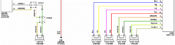

Im trying to install a JVC headunit into a 1999 Mazda Millenia and I cant get the front speakers to work with the JVC radio. I have a harness so I didnt have to cut any wires. When I hook up the stock radio it works fine. Anyone know what I can do?

I meant ALL the speakers. I cant get any of the speakers to work with the aftermarket radio. The stock radio is Bose and I was thinking it has an onboard amp and somehow I need to bypass it. Does anyone know how?

on that car you have to run all new wires from radio to speakers.

yeah, Tjmutlow is right,re-wire this s^^^^

As I see you got a nice sound system with center speaker...like in acura TL)
