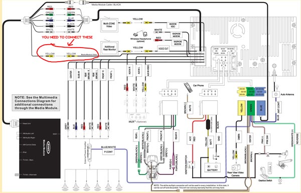

Username: Ukone
ok i have a jensen vm9511ts and ive looked at the wiring diagram trying to figure out how to bypass this damn parking brake thing excpet on mine the parking brake and gearshift are all wired in together somehow and i reall dont get how im supposed to wire both these wires in order to bypass i have two wires left to hook up the green/white(gearshift also labeled as reverse+) and the pink which is the parking brake but they have a wire connecting them in diagram and then are both hooked into battery?? please help heres the link click on find manual the diagram is page 7
http://www.audiovox.com/webapp/wcs/stores/servlet/ProductDisplay?catalogId=10001 &storeId=10001&productId=15216&langId=-1
Username: Ukone
foget it i figured i out i was overthinking it i jsut had it explained to me that the e-brake wire is the one that needs to be gorunded via switch and the gearshift wire is only used in conjunction with a backup camera so the stereo know when you go into reverse
thanks anyways
now to go see if it works

Username: Speck
I have just installed a Jensen VM9021TS in my 2005 Tacoma and the hooked the parking break wire from the unit to a toggle switch and then grounded the switch. Hit the switch 3-5 times and the DVD works while driving. I cannot however get the TV to show a picture. Sound comes through yet no picture. Any help would be greatly appriciated.
Username: Jmdigital
Stephen -The good news is I know what you did wrong. The bad news is you have to take the radio back out to fix it.
The yellow cable on breakout cable from the tuner box goes to the MediaVideo in that is directly attached to the RADIO it does not connect to the yellow end that is grouped together with the RED GREEN BLUE BLACK WHITE. I did the same thing , the yellow that is attached to the other colors is a sync cable that is not used.
Username: Speck
Jmdigital,
Thanks for the help. I did not plug in the yellow into any other wire. Is that what you are saying I did wrong?
Username: Jmdigital
Yes.. thats it. The yellow wire from the MEDIA MODULE has to go to the yellow wire from the radio.. The MEDIA MODULE box that has the big breakout cable is like a vcr and the radio is the tv. It has to pass the audio and video to the radio. The reason you only hear the tv audio is because you hooked up the other color wires. Here is a jpeg of what you need to do.
