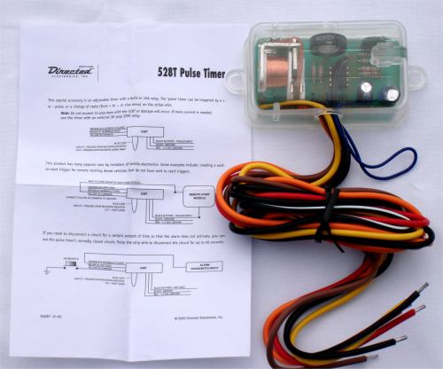

I figured out that the diesel engine on my 84 mercedes 300D shuts down by a fuel cut-off solenoid that is entirely mechanical and connected directly to the ignition switch. If one was so inclined to do so, he can connect the two vacum hoses that RUN DIRECTLY TO THIS SOLENOID(YES TO THE IGNITION SWITCH)to each other. Now having these connected together with a small rubber hose, he can simply pinch the hose that is connecting these two and shut off vacum air going through them. Try the remote start while holding this hose tight. It will finally start! Let go of the hose to shut the engine off. Having done this leads me to connect a timer relay up to an electric vacum on/off. The HT-800D+ is looking for an electrical cut off, however there isn't one. So one has to be made. I bought a timer relay off ebay for 16.00 and had an electric vacum on/off. The plan is to get the relay to trigger from a negative (-) so when the alarm computer shuts the car off, the relay will pick up the (-) and switch the solenoid open for 3 seconds or so, cutting off the engine. So now the engine cut off is "electronic", which is the language of the alarm.
Relay: VIPER CLIFFORD CAR ALARM DEI PULSE TIMER RELAY 528T
12V Electronic vacum on/off: MAC MODEL 35A-AAA-DDBA-1BA
VOLTS 12
WATTS 5.4
UP TO 120 PSI

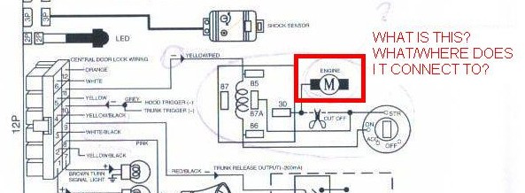

I am getting ready to install my HT-800D and am curious about 2 things on the install diagram. What do I connect to this engine pic and what is the brown wires for? Double pulse/single pulse lock/unlock?Upload
Username: Vaggabon
Also, what is this for?

***Engine means that you cut the starter wire and one connect the two thick wires of the relay on to the starter wire part that heading to plug, and the other the second part of starter wire which exactly heading to starter engine.

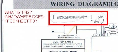

*** The single pulse/double pulse wire if cut opens only driver door, if connected all you can open only driver door with one press on button or all doors with double press.

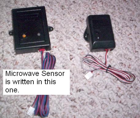

I am not sure which is what? I thought that the one that says microwave sensor (on left) was the communication module. Is it really the shock sensor? Thought that because it says adjust sensitivity on the orange dial. Is the one on the right the communication module then?
They both have dials/knobs to make adjusts .
Username: Mmouse
Toronto
Emmet:
actually it doesn't matter where you connect each one of the sensors as both inputs are the same.
and on the picture microwave is from the left, shock is from the right.

Frankly I donno what is this. I've got mine alarm without this metal thing. Actually I don't think you need it anyways.

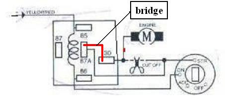

That's very simple:
You go to ignition harness plug (on the steering wheel column), find the ignition wire ( mine was thin red wire) cut it about 3 cm from the plug.
The side closest to the plug you connect to the middle contact of relay (87A), the other side ( the longer part of ignition wire that heading to the starter engine) you connect to contact (30).
That's it.

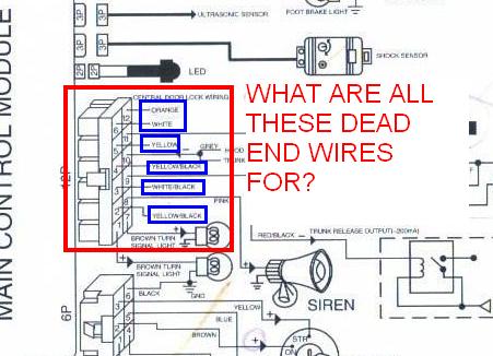

I am going good here. Anothr question. What are these dead end wires for. The diagram shows them connectinfg to nothing. Do i just cap them and leave them?

Emmet: Part of these "dead" wires are connected to door lock /unlock wires. Consult your door lock diagram.

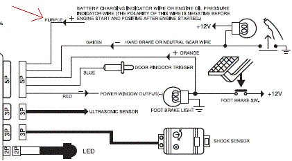

Username: Geronimo4000
5P
Purple – This wire goes to the battery charging indicator or to the engine oil indicator. Also, if you don’t find one of these wires you can connect it a wire with constant +12v or a wire that when you start the car has +12v. I jumped mine with the +12v of the alarm. Note: If you don’t connect this wire the car won’t start remotely, the car will start but it will shutdown in about 1.2 sec.
Green – this wire goes to the hand brake. It goes to a pin that makes ground when you pull the hand break. Also if you don’t find this cable you can connect it to ground polaroid or to the chassis of the car, but this is not recommended.
Note: If you don’t connect this wire the car won’t start remotely, the car will turn on but it won’t crank.
Orange – this wire goes to the stop light cable, for easy finding check the foot brake and look for a switch with 2 cables and follow the cable that doesn’t have power (it receive power when you press the brake)
Note: if you start the car remotely and you press the brake the car will shutoff.
Blue – this wire goes to the door sensor it can be + or - . The alarm is set to – by factory to use + see the jumper table.
Red – this was the only wire that I didn’t connect, but I think that it’s for the rollup window.

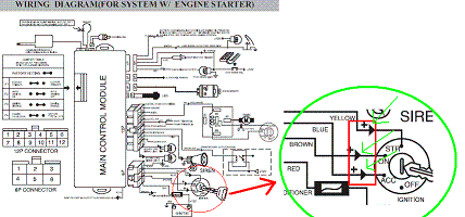

I HAVE QUESTION REGUARDING THE 3 DIODES ON THE SIX PIN (6P) IGNITION WIRES. (SEE PICTURE).
DIODE ARE ONE WAY FLOW e-. MY QUESTION IS IF I
INSTALL THESE DIODE, MY ALARM WILL NOT KNOW IF THE KEY IS ON WHAT POSITION OR ANY POSITION.
SO THE BIG QUESTION IS FOR THOSE WHOM WAS ABLE TO GET THEIR ALARM WORK WITH ALL THE FEATURES, "DID YOU USED OR INSTALL THE THREE DIODE AS SHOWN ON THE DIAGRAM"?
NOTE: DIODE NOT INCLUDED IN THE ALARM PACKAGE.Upload

XIONG: These are only arrows that show current flow direction, not diodes, so you don't use any diodes at all.
Regarding 'owner recognition" feature mine worked well and I in order to turn it on I operated according to manual - so try it again. Personally I dislike this feature and turned it off as every time I park my car beside my house the car may open up without me noticing that. It sences the remote control in 10-20 meters range , so it kind of dangerous feature.

I have a couple of questions about this system. Can you attach the
(5P Purple – This wire goes to the battery charging indicator or to the engine oil indicator) to the tachometer?
Also I have to connect the (Brown – it goes to the turning signal) to a negative parking light I assume it is the same as the turn signals. I noticed that the wires are positive will I need a relay since I need to connect them to a negative?
One more question is on the hand brake wire any clue where I can pick that up in a 2001 Hyundai Elantra?
Thanks for any feedback
-You can’t attach it to the tachometer, but you can attach it to the same +12v wire of the alarm (the red one in the 6P)
-Yes, you can do that, but with the relay, but make sure that you attach the wire to the turning light and not to the stop light.
-You will see a pin some where in the hand break. This pin is like the door’s pin. Attach the wire to the cable that only makes ground when you pull the hand brake.
If you need more help, this is my email party_boy_xxx@hotmail.com

Hi there, I was wondering what the deal is with the starter kill relay. The diagram seems to tell you to hook the yellow wire on the relay (position 86) to the "on" wire on the steering wheel column but there is no mention of this in this forum. Do i do anything with this yellow wire or just tape it up.
Username: Browerb
Registered: Jan-07
I believe you would splice it into the on wire in the ignition harness. the same wire you connected your brown wire from 6p.
Post Number: 8
corey:
There is a bridge between the contact 87A and the contact 30, so when you complete the circuit with +12v on the contact 56 and ground on the contact 85 the bridge opens.
Yellow/red – This is the ground. When the alarm goes on it will send ground to complete the circuit.
The contact 56 goes to the ON wire. So, when you try to start the car, when the alarm is on, the alarm will send ground and you will complete the circuit (with out knowing) when you put the car in on position. The bridge will open cutting the starter cable.
So, cut the starter wire. The side closer to the plug goes connect to the middle contact of relay (87A), the other side (the longer part of ignition wire that heading to the starter engine) goes connect to contact (30).

Nicholas Khan, your problem may be one of the two reasons.
1. If your car attempted to start 1 time only,
check the 5p connector, purple wire. Use a volt meter. This wire should have the following readings
key on "acc" position = 0 volt DC.
key on "on" position = 0 volt DC.
key on "engine idling" = 12 volt DC.
If you are not getting the same reading as above, your technician
may have connected the 5p connector purple wire to an ignition wire. Most technician will do this get away with it especially in newer vehicle and in warmer climate temperature region.
The 5p connector purple wire should be connect to a special signal in your vehicle that has 12volt or higher only when the vehicle successufly started up and idling. This is why manufacture suggested connected to charging system light or oil pressure switch. If the vehicle failed to start up, the 5p connector purple wire will get a negitive or a 0 volt reading and letting the alarm know to reattempted to start again.
(I am not very good in english please ignore my spellings and grammers hope this help)Upload

I'll tell you guys how to fix the remote start problem. Rip it out of your car and buy the Viper 7900 (color lcd display and remote start) - thats what I did and i'm loving the new alarm...lol. I really hated the blinking hazard lights when you open the doors for Huatai alarm & the intermittent remote start. You can get the Viper 7900 from www.hookedontronics.com for an excellent price.
Username: Khamblin
Houston , Tx
U.S.
To fix the remote start problem, just splice the purple wire to the red constant power wire. This will keep the engine running.(thanks Geronimo, for this info. it helped out a lot.)

how do i connect the 5p red wire and what is the function for it?
Username: Noexpert
Chandler, Az
Usa
Post Number: 10
Hi There, I had a similiar problem and found out it was the connection of the purple wire in the 5 wire harness. I tried oil pressure and tach points, finally hooked to a constant 12v sourse and the problem went away.
Username: Kendixon69
Nogales , Az
United States
On the HUATAI HT800D alarm the P5 connector goes as follows PURPLE goes to theback of the fuse block on the fuse that runs between the engine run and the alternator. GREEN goes to the top on the parking brake on the switch. RED goes to the back of the fuse block onn the wire that has the electric windows circuit breaker/fuse. BLUE goes to the light under the dash that is on when the door is open ORANGE goes to the power wire of the brake switch.

todd try this check the 5p connector, purple wire. Use a volt meter. This wire should have the following readings

Post Number: 7
I have the purple wire 5p connector straight to the constant 12v that the power wire 6 connector for the unit connects to. So it would show 12v all the time. It worked again today half the day, but when I set the alarm and let the car sit for a couple hours, the remote won't do anything. I'm sure tomorrow after driving for a couple hours will work again. I am sure I have a wire misplaced. Huatai website: www.huatai-alarm.com/
Nogales , Az

The purple wire 5p connector, you said it should have the following:
Is it ok to have it to a constant 12v or does it have to have those readings you have above? It is just weird that when the unit is working I can set the alarm and it works fine, it is just when I leave it for a couple hours that the remotes don't read the unit anymore and the system stops working. When I come back to the car the alarm is still armed, I have to open the door with the key then the alarm goes off. I then hit the valet switch twice which then shuts the alarm off but after that the system won't work until the next day when the car is driven for a couple hours. And what would I hook the purple wire up to that only has 12v when the car is idling?
Username: Anoose2002
Boise, Idaho
Todd,
the purple wire should not be connected to 12v constant, when the eng. is off it should be 0v, only 12v when the eng. is running...try to find the oil lamp.

Username: Jvr20
Registered: Nov-08
Hi.
I bought a ht800d but it only has a shock sensor and no ultrasonic sensor. The main unit as also only one 3P connector. I have an ultrasonico sensor. How can i connect both at the same time? Does the shock sensor detect when a window is broken?
Thanks for the help

Hi, I also bought a HT-800d and was wondering what some of the extra wires are for(yellow, yellow/black,white/black), can anyone help? also this remote starter is suppose to be a diesel model. Can anyone tell me how to program it to delay start or is it already set. If so how long of a delay is it?
Username: Noexpert
Chandler, Az
Usa
Post Number: 12
Hi there, In regards to the extra wires there for the door locking/unlocking feature. I know nothing about the diesel features for this unit. Maybe you can find some help at http:\www.the12volt.com site
