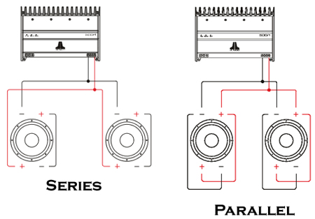

I don't know whats going on! i have 2-10inch pioneer premier ts-2504 dual 4 ohm! I have a 1ohm stable Kenwood KAC-9152D 1800WATT BUT I CAN TURN IT UP, AND POP GOES THE FUSE! I PULLED EACH SUB OUT AND THE RED IS GOING TO RED AND BLACK TO BLACK ON ONE COIL, THEN RED TO THE OTHER RED AND BLACK TO THE BLACK! IT SORTA LOOKS PARRELELL WIRED DOWN EACH SIDE OF THE SUBS! SO, WHAT OHMS AM I AT THIS POINT? HOW DO I GET IT TO 1 OHM?

I'm stumped! I need to know how to wire my dual 4 ohm subs to 2 ohm stable! Anyone know how to like explain this to where I could understand it? Thanks, I really like this new site! I think its a great thing when people help each other out!! PEACE! ~~ROBERT~~

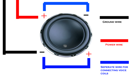

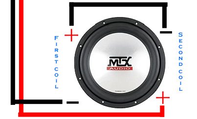

go here
http://mobile.jlaudio.com/support_pages.php?page_id=161
this is series which is= you connect the positive on second coil and the negetive on the first coil then you take a seperate wire and connect the positive coil on one side and connect it to the negative coil on the other side like in the picture below(that will power two dual 4ohms at a 4ohm load)
And do this set up for Dual 4ohms at a 1ohm load(parallel)

I can't make it any clearer than that
