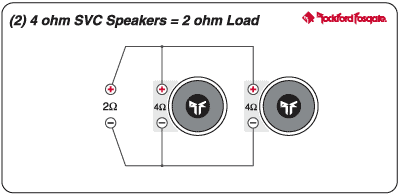

ok, im assumeing they are single voice coil 4 ohm. so you need an amp that does aroud 5OO RMS at 2ohm.

i doesnt madder, if you get a mono, you will wire them like this...Upload

if that is a single 4ohm then a 2 ohm mono amp, if those are dual 4 ohm subs, get a mono 1 ohm or a 2 channel amp. do not buy a 2 channel amp for 2 single 4 ohm speakers.

yea, it will power both of your subs. they will each be getting around 4OO watts RMS.

Trevor.. can you show me just like picture of how there gonna wire it? Is it gonna be bridged or how? Remember I have 2 subs. Just show me a diagram of how it's gonna be done.
Username: Tdawg30
Ohio
Post Number: 428
the top one is how you should wire it.....
http://www.crutchfieldadvisor.com/learningcenter/car/subwoofers_wiring.html?subs =2&impedance=SVC4
any other questions, just shoot away.
Username: Thakidgame
Hialeah Gardens, Florida
U.S.A.
Post Number: 48
Trevor I think my subs are single voice coil.
