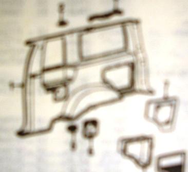

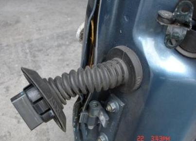

this pic.from ford.ex. sport (two doors),but it will give you idea,how to get there.

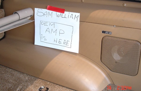

Post Number: 114
for Sam: location of oem Amp.

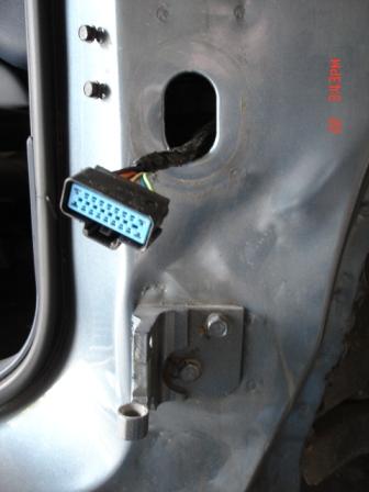

ok Mike, I know this isnt an AUDIO question, but has to do with wiring, so here we go, I just recently purchased some new side mirrors for my '98 Cavalier, well they have led lights to connect to the blinkers, to make for a newer style blinker, well Im not sure the colors nor the location of the original blinkers to hook into could ya help me out
Username: Leew
Ketchikan, ALASKA
Post Number: 540
Nicholas you have two choices:
short way:remove trim panel on a door/be carefull,dont broke plastic retainers/.then remove turn/hazard-headlamp swith assembly and look for light blue(for left turn) & dark blue(right turn) wires.Run new line through post to the mirror with main line(like speaker,power windows,locks...etc.).Watch out for glass,when it's going down,glass can cut your new line.Ground wire you can connect into any unpainted metal place inside of the door.Put everything back.Do the same with another door(if it's right door then the wire will be much longer.)
make everywhere proper connection!
application/x-zip-compressedUpload
chevy.cava.1998 turn signal on a mirror.swith assembly.zip (7.6 k)
second way:
you can run each line,straight from park/turn signal lamp.Wires is the same color light blue for left turn signal & dark blue for right turn signal.But when you open the hood and see all this wires going to somewhere,it's looks...you know how..
chevy.cava.1998 turn signal on a mirror.zip (7.6 k)
let me know,if you got some problem.
Goodluck.

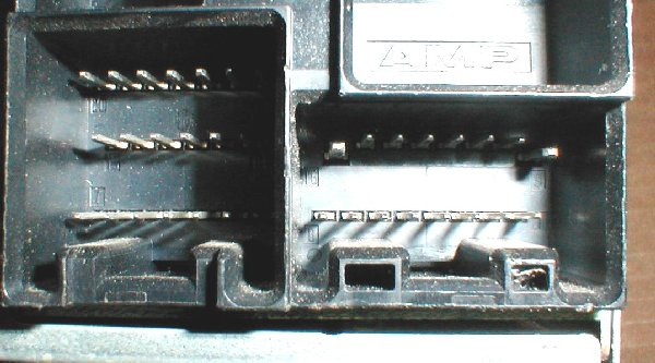

Username: Weldmen
Hello Mike,

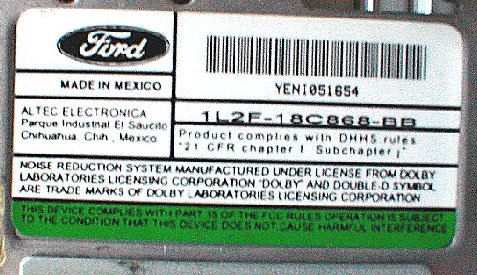

I am looking for the pin out diagram for a 2001 ford radio. T100 plug end. I have attached some pics for reference.
Thanks
Weldmen
Username: Leew
Ketchikan, ALASKA
Post Number: 548
It's very hard to say,ford make alot of modification. I need:exactly from which model of ford the radio was pulled out.
Username: Leew
Ketchikan, ALASKA
Post Number: 549
if you not sure from which model is it,make me pictures of the label with serial and model number & monday I will call to the ford dealer.
Username: Weldmen
Hey Mike,
It is out of a Explorer I think. But here is the pic of the tag on back.Upload
Username: Leew
Ketchikan, ALASKA
Post Number: 550
ford explorer 2001 base model:
base radio ford explo 2001.zip (19.6 k)

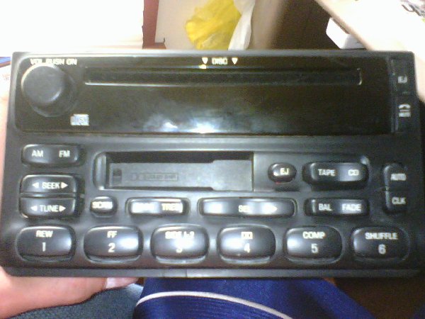

I have a 97 ford explorer with a stock face and I needed to get a adjustable line output converter for the avs for the subs but i dont knwo what wires go to what and i dont know all the of speaker wired on my truck, can anyone help ?

John Martin ,time to change radio.If you prefer original HU,then go to local junk yard ,Iam sure they have it in stock...,dont pay more then 150$ for the HU.

Username: Littleozzy
Sorry It's not me,it's Jenifer Contreras,she helps you out.
You have to remove Trim panels on a doors and center pillars,then take out ruber boot and run wires through,like main lines...

Faribault, MN
I need help figuring out the stero wiring color codes for a 2004 Chevy Cavalier. Please, i really need help! Thanks!

Username: Ixj22
Faribault, MN
Post Number: 7
hey jennifer, would mike be able to also tell me what the wires do (like, acc, negative, positive...)thanks i would really appreciate all your help
Username: Leew
Ketchikan, ALASKA
Post Number: 569
Hola Jen.
well...

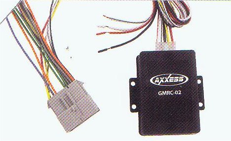

Israel Rivera,I need more info about yours HU,do you have oem amp,or satellite radio.Do you see some labels/like U-85 or U-82/.
BTW. I tell you now,there is no ACC wire in your system,it's controled by BCM,so you have to run new ACC line from cigarette lighter to new HU !

Israel Rivera,this what you need:
The name is gmrc-02...~80$,I saw on e-bay for 30$
