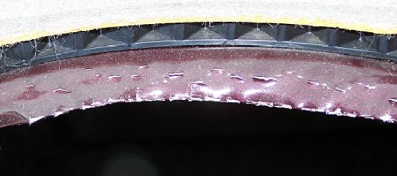

here on the first pic you can see where i took some pliers and just bent the metal down. its pretty easy to do.

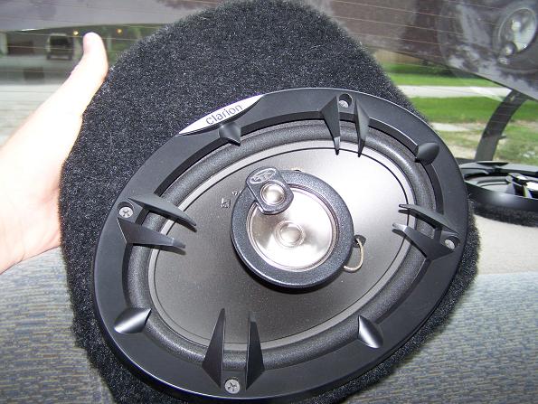

then the second pic is just to show you that the shape of the wood frame will need to bethe shape of the factory grilles. just flip the factory ones over and trace em on wood, then make the cutout of the 6x9.Upload

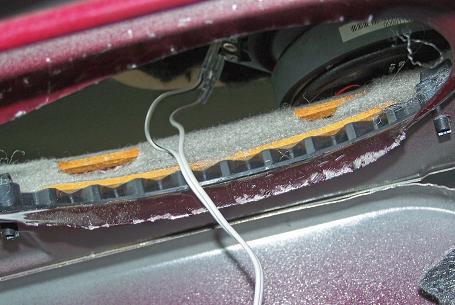

then finally the last shot is just another view of how I bent the metal.Upload
