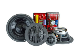

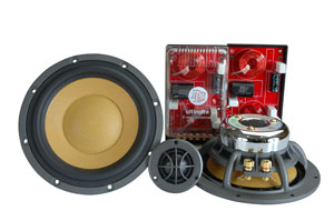

Coaxials
2-way components
3-way components
