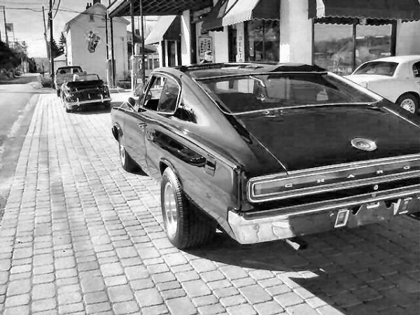

that RR has a load of room. you're not that limited
radio can go in the glove box area or under the center console in a fiberglassed section to hold it.
front speakers go in the kick panel areas in fiberglassed kickpods holding 6.5" separates, subs in a box in the trunk, remove rear deck speakers to vent trunk into cabin.
amps in trunk in custom layout if you like.
Pretty much the same thing I did with my Charger.

Great....I got ya now Wolf. As far as the 6.5 separates go....did you use surface mount tweeters up high like at the A-pillars? If so who makes good surface mounts? I was thinking MB Quart. Did you power the fronts from the HU and amp the rear or other set-up? Sweet Ride by the way.

in my case I have a 3 way system in front, all in the kicpod area including the tweeters, nd no rear fill with a single 15" in the trunk where the spare tire went.
I used fiberglass to make pods that hold the 8" midbass, 3" mid and 1" tweeter, and keeps it all pretty stealthily hidden so youdon't really notice much in the car, and everything stays pretty stock looking nd useable.
