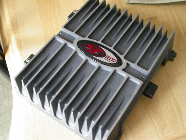

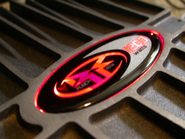

Cool, if you would rather do a trade, I also have a Rockford Fosgate Punch 401S amp that works great, just missing the end plates (not necessary for anytning) and the terminal screws for the speakers(which can be replaced easily). I could ship it USPS priority mail as part of the trade.
100 watts RMS x 2 at 4 ohms
200 watts RMS x 2 at 2 ohms
400 watts RMS x 1 at 4 ohms in bridged mode
50-250 Hz high-pass/low-pass (12 dB/octave) crossovers
If you want me to throw in a distro block or some cable, I could do that. I'm still good with the $50 trade too if you want. I need to get rid of this amp :-) Give yourself some time to think about it and let me know: spinsharp@gmail.com

Post Number: 117
Thanks for the offer but Yea I would have no use for the amp. Sorry though I think I will just stick with the kappas for now. They definitly get the job done.
