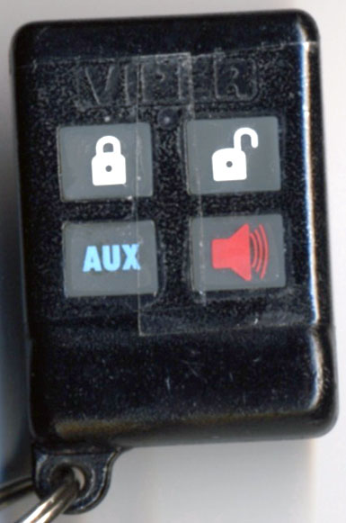

LONG STORY SHORT: I bought a new remote and can't figure out how to program it (I don't understand the instructions on the package). I have a 99 Grand Caravan Sport with a Viper 550 ESP Alarm in it. I have one fully working remote - here's the info on the back of it:
1-800-274-0200
266 Rolling Codes
FCC ID # EZSDEI475
The front has 4 buttons (LOCK / UNLOCK / SILENT MODE / PANIC) & green LED (see attached photo). It has Remote Start (pressing LOCK & UNLOCK together).
All I want to do is program my new 4 button remote (474V) to do exactly the same things that my old one does without changing the programming on my currently fully operational remote.
Thanx in advance!!!
Username: Grafixjoe
BIG PROPS to skaterbum for walking me through my dilemna!!! He hooked me up with the 550 ESP Install Manual and talked me through the 30 second procedure:
(Open Driver's Door / Key to ON position / Within 5 seconds, Press Valet Program Button 8 times & hold the 9th / Press LOCK button on remote / release Valet Program Button / Remove key).
The procedure programs ALL the buttons!
SKATERBUM ROCKS!!!
Thanx & God Bless, whoever you are!
