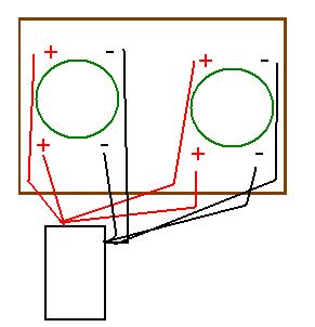

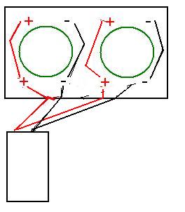

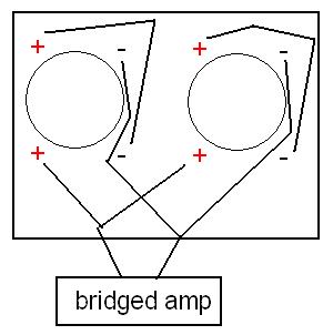

Username: Fandim
Reno, Nevada
United State...
Post Number: 937
Registered: Jun-05
Example A
Example B
Example C
In your situation, any of the three pics I posted here, will give you a final of 1 ohm impedance.

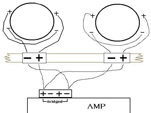

Username: N2audio
Lawrence, Ks
Post Number: 843
Registered: Mar-04
seth, he needs a 4 ohm bridged load for that amp, not 1.
I'd do it something like this...

well.....i have two terminals on my box; so that means i have a postive and negative speaker wire from each terminal cup to the amp....so the plan to just use the 12volt diagram doesn't exactly work, but here is how i think i'm going to do it:
wire each sub in series and connect it to its' terminal, then take the (-) output from terminals one/two and connect it to the (-) bridged channel on the amp, then do the same with the positive wires
IF i'm correct this should give me a 4ohm mono load...the question is, am i correct??

Username: N2audio
Lawrence, Ks
Post Number: 845
Registered: Mar-04
yep - that's how I drew it up

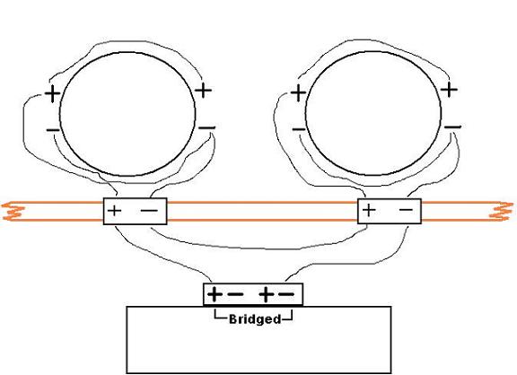

Username: N2audio
Lawrence, Ks
Post Number: 846
Registered: Mar-04
uhh - check that - I had it parallel/series - but the load at the amp's the same.
This would be series parallel --
