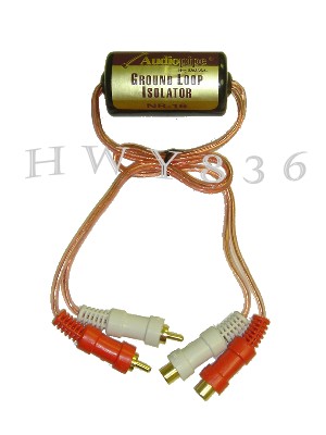

Ok... Well the relay will not help... It wont hurt to install it tho...Sounds like a bad ground some where.. Ground both amps at the same point keeping the wire as short as practiple..Make sure the wire gage is a least the same size as the power wire. Make sure the ground wire from the battery to the fender, firewall is ok. wont hurt to upgrade it either. if all else fails try a ground loop isolator. I am running 5 amps and have one just before entering my amps. It deffinatly cut out all the wining and buzzing. I even removed the door open and headligts on buzzer under the dash because it was being AMPED thru my speakers. Now even with the volume off there is no noise. Luckily, they only cost @ 10.00

and where can i grab one of them at

Radio hacks or wallymart I got mine at an electronics store. Save the package to bring back if it doesnt work... Most importantly check all your grounds again. 9 out of 10 its a weak ground some where that causes noise in the system. I thought I had a bad amp cuase the noise only happened when i connected the fifth amp. Out of fustration I got the Ground loop thing and it worked...

marc thanks for all the help so far... im gona go buy one of them groudn isolaters today...but i think its the location of my ground... but i dont know anywhere else to put it right now its on the back of my back seat in my trunk, like u kno how theres metal on the back of the seat , its there , should it be sonmewhere else.?
