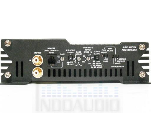

Im using the HU crossover HPF for my front stage at 12db @ 80hz
I plan to use the crossover on my XXK-1500 to my ID MAX 12 subwoofer sealed.
Should the crossover be set at 24db @ 80hz for the LPF on this particular amp ? I dont have a option of 18db slope on the amp but i do on the HU but i think im suppose to set the lpf on the HU to full to turn it off right ?

Here is a picture of the amp controls. What should i be setting all of these to for it to blend in well with the rest of the system. Thanks
