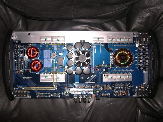

Ya, no kidding, I have a Xenon on my work bench right now, that thing is huge! The Kicker is awesome, the caps remove and it is a lot shorter! Actually I am surprised it puts out sooo much for such a small package, nice and heavy too. Ever see what your PG looks like inside? It is well built, here is a picure. Polo..Upload

Polo, are the PG amps internally fused or no?
Also, how did the testing of your 1200.1 go? how much did it vary from 1-4 ohms etc?

PG amps are not internally fused, I recommend a 150 amps inline. I tried a 90 and a 100 amp and they blew with some old Bass 305 tunes, lol. It delivers the same amount of power from one ohm all the way to 4 ohms! At 1ohm ths thing barely gets warm, and mine puts out 1390 watts. I love this amp but I wish it had the digitals DSP like my new Kicker sx1250.1's's. The PG amp uses quality Fairchild Fets, nice setup for a mass produced amp IMHO...Polo.

Polo - I know it's supposed to deliver the same amount of power, but there is normally at least a little bit of fluctuation..?
Also, have you benched these at lower voltage, like 12v and seen how much they put out? That's something else I'm very curious about.

Actaually there isn't a power fluctuation at all under different loads it sees 1ohm no matter what!I have heard someone running it down below 1 ohm but do not know how accurate it is. The load is controlled by a circuit called Xe Load which is quite nice very flexible and I think running your subs at 4 ohms may sound cleaner? I have not gotten to bench it but I have dragged my battery down to dirt and have not heard a noticeable difference. I was also told by a reliable source that they can play all the way down close to 11v. Polo..
