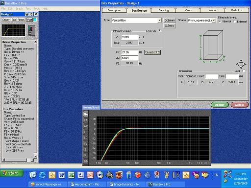

I got almost the same numbers using BassBoxPro6;
VB=2.893 CF (blue) optimum size as per BBP6
FB=21.95 Hz
QL=6.591
F3=26.93 Hz
DV=4"
LV=21.26"
VB=2.5 CF (yellow)
FB=22.81 Hz
QL=6.591
F3=28.4 Hz
DV=3"
LV=12.23"
VB=2 CF (red)
FB=24.19 Hz
QL=6.591
F3=30.82 Hz
DV=3"
LV=13.93"

VB=2 CF (red).....= BOX SIZE
FB=24.19 Hz.......= PORT TUNING FREQUENCY
QL=6.591..........= BOX LEAKEAGE LOSSES
F3=30.82 Hz.......= FREQUENCY CUTOFF 3DB BELOW PAR
DV=3".............= PORT DIAMETER
LV=13.93".........= PORT LENGTH
2.0 cubic feet is the net volume. You must add for the port and driver displacement.
3" X 13.93" port displaces the volume by .0669 cubic feet. The driver displaces the volume by .12 cubic feet. So make the box 2.1869 cubic feet or 61.93 liters.

If you are looking for a total 2 cubic feet interior volume then consider this;
VB=1.809 CF* / 51.23 Liters
Total volume = 2 CF* / 56.63 Liters
FB=24.83 Hz
QL=6.591
F3=31.98 Hz
DV=3"
LV=14.76"
