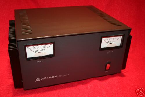

with that high wattage of an amp you may be better off buying a ham radio power supply. But if you go buy one of the pc power supllies in the 550 watt range you should be able to power it for the most part. how many subs are you powering?

Why mess with trying to use a PC power supply? Won't a standard 13.8VDC, 20 amp power supply, used for test benches and ham radios, etc work? I've seen a number of them for sale on eBay for less than $30. 20amps should be sufficient for at least 250 watts, shouldn't it?

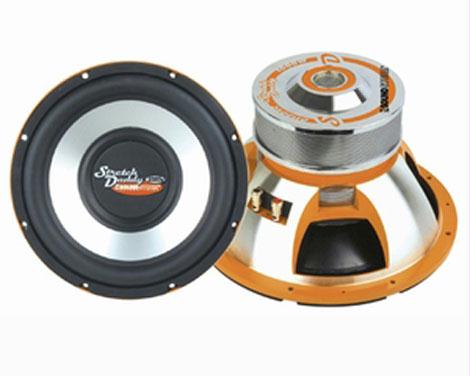

I need some help i need to hook up my car amp in my house but how to i go about getting power to it and what do i use for the REMOTE wire??? Any help would be great please send info to bigrich_101@hotmail.com or leave info in here THANKS!!!
Mr. Stretch
Unregistered guest
I wanted to use my two 12" subs in my room and hook them up to my panasonic stereo. I used the pc power supply to power my car amp and hooked my subs up to the amp (i followed the directions given by "Evil.Commando" above). I hooked my panasonic stereo to the amp with the rca cable. However when i try to play a cd it only comes out of my stereo speakers and not the subs. When i switch my stereo to AUX it should work but it doesnt. It doesnt play anything on AUX. I read my stereo manual and it says i need an analog player with a built-in phono equilizer and the switch needs to be set to "Line Out" position on the back of the analog player. I don't think my amp has this phono equilizer or a switch for line out. Any suggestions to still make it work. Thank you Very Much.

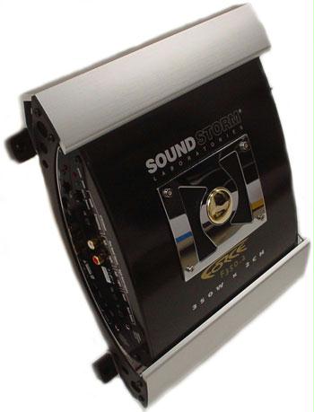

Username: Audioluv2222
Cambridge , Ontario
I was wondering how to power my amp off of a switching power supply, i currently have 2x Soundstorm DC-112DVC Car Audio 12 Inch Sub Woofer Speakers(RMS Power Handling:450 Watts),and a Soundstorm F350.2 Car Audio 2 Channel Sub Woofer Speaker Amp Amplifier
(350W rms x 2)
My Subs:
http://www.hifisoundconnection.com/Shop/Control/Product/fp/vpid/1331953/vpcsid/0/SFV/30046/sret/1621121621521422122028122219282219228285216229234289220229226295232237236233226231228245232231244
My Amp:
http://www.hifisoundconnection.com/Shop/Control/Product/fp/vpid/1541536/vpcsid/0/SFV/30046/sret/1621121621521422122028122219282219228285216229234289220229226295232237236233226233234231234245246
I was would like to know everything i need to know about being able to power my amp off of a computer power supply, before i go out and buy one, can someone please email me with pictures/instructions on how to do so at * zane_mike2k4@hotmail.com
ThanksUpload

You need a high amperage power supply as shown below, that's it. Try Astron or Tenma. If you use a car battery, you're incredibly stupid and must have a death wish.

Actually, computer power supplies are a bad idea. They have next to no output filtering (lack of caps) and the heatsink design is poor. Not to mention all of the bad caps in them as of lately: http://en.wikipedia.org/wiki/Capacitor_plague
Dedicated power supplies will last decades, computer power supplies..hardly years. They're crap.

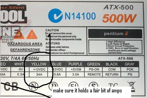

dear people of earth,lol, seriously im going to explain how to wire up your amp safly.
first you need a good powersupply or two or three.
if you are going to use a computer powersupply you must use diodes or you could cause damage to the power supply unit., as these power supply have a rating of there maximum ampage. once you exceed that ampage by adding another powersupply, the parts internally can go bang!. so if your using 1 power supply, then you don't need a diod.
basically my setup is rather simple.,
first check how much your existing car amp is going to drain? how much amps you say, well a good way of telling this is to look at the fuse that it comes with, if your fuse is rated at 30amps, then get your self 1 computer 30 amp power supply or above. for older computer power supplys, lets just say you have a 15amp @ 12volts, well get 2 computer power supplys, join them together and you have 30amps. point is, your probley never going to be draining that much amps, but it is safe to do so incase of power spikes.
ok, so lets just say you have a car amp which drains 80 amps (like me) and packs a punch.
well the first step, is to get a decent computer power supply.
now as you can see, my power supply provides 34amps @ 12volts. so im going to need three power supplys, making a total of 102 amps, thats 20 amps or so more than i need for my amplifyer, which is good.

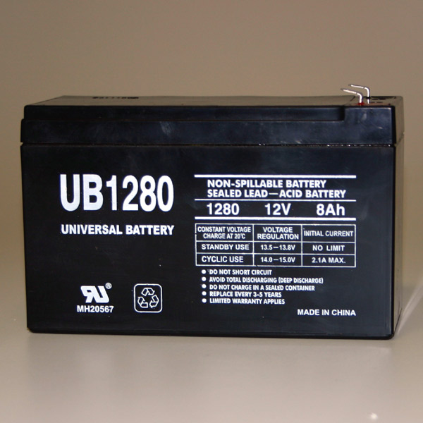

second step is a battery (sealed), the reason why is the spikes your amp takes from the power supply, and not to mention that a battery will act like a big capacitor. which will get rid of buzzing noise.
then we need some diodes, you need to make sure the diodes have a higher amp rating then the power supply, now alot of people are like but we cant find a 100 amp diode. thats fine, just combine the diodes parelle to eachother, and it will double the amp rating on the diode. so you get 3 30 amp diodes,combine them together and you then have 90amp, (as long as your car amplifyer does not drain more than what the diodes supply.
now comes the wiring,
the yellow and black wiring found here.,
must be combined., get all the yellow wires and all the black wires from the hard drive connector. and wire all the yellow wires together, and all the black wires together, DO NOT PUT THE YELLOW AND BLACK WIRES TOGETHER. the yellow is your +12 positive as in your red wire in the car world. and the black is negative -
now all the blacks will connect to the negative terminal of the battery, and also to the negative terminal of the amplifyer.
all of the yellow wiring comeing from one of the power units, will then connect to the 34amp diode. (if your unit is more or less amps your diodes need to be of the same value or stronger than the unit. and do the same two the second power supply and the third.
i drew up a diagram, this should help you all understand what im talking about.
if you can't understand it, i don't recomend you playing around with electricity. its dangerous if you don't know what your doing, if your wiring isnt thick. and is untidy, it could catch on fire! be careful. you have been warned. keep in mind the power units and the amp need good air ventalation. excuse my spelling, im really rushing this so i havnt checked what i wrote. :-) enjoy.
Mr T diagram
as you can see, ive made a simple paint picture diagram, follow that, and you should be fine.
the blue wire is the remote wire, it turns on your amplifyer, ive put a small picture of a flick switch which connects it to the positve., this does not need to be thick, as remote draws small current. also if you have a powersupply that requires a motherboard to turn on, just put a switch between the two pins mentioned at the top of this forum page. enjoy,
