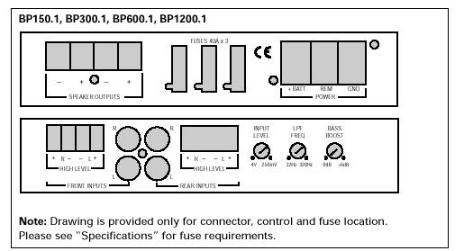

Hi,
I bought a JBL BP300.1 amp and i have some questions. I am kind of new to car audio, so please bare with me.
Anyway, there are speaker level outputs and RCA outputs. It says some stuff about fading and nonfading bass the speaker level outputs. Im not too sure what this means since i have never dealt with an amp with them before. Do i need to hook my speakers up to those outputs? Also i will be running 2-12" rockford punch stage 1's(the new ones).
If you need more info please feel free to post and tell me so.
Username: Glasswolf
NorthWest, Michigan
Post Number: 2177
Registered: Dec-03
put Y splitters on the RCA jacks
then connect both lines from the head unit to the (now) two RCA jacks of the JBL amp. this way all 4 inputs get signal
the speakers connect to the speaker terminals.
ignore the high level input portion unless you are using a factory stereo to run this amp.
Username: Element8276
Registered: Apr-04
So i get y splitters and connect those to the amp, my head unit only has one set of RCA's.
basically i connect the rca's from the Head unit and then get y splitters and connect to the end to the amp?
Thanks for your input
Username: Glasswolf
NorthWest, Michigan
Post Number: 2190
Registered: Dec-03
yeah run one pair of RCAs from the head unit to the amp
at the amp you use two Y splitters to give all 4 RCA inputs a signal.
all done
