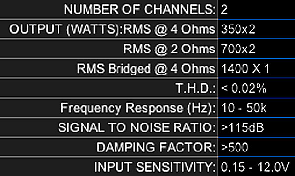

Username: Audioguy22
Post Number: 107
I dont feel that the class of amp is so important, what you need to look at is the Damping factor and the rise time or slew rate.
The higher the Damping factor the more contol the amp will have over the woofer. Higher damping = tighter more punchy sound.
Post Number: 108
Hey Glass, thanks for that. When a switched my sub Amp(and nothing else) with a better amp with close power ratings but different damping factors, I noticed a hugh change in SQ! The bass got really tight and punchy and a lot of the noise(rattles)had gone. when I look at the specs of both amps, the big differents was the damping factors.
Thats what I'm going on here, and my years of home Hi-End amps where the higher the better when it comes to DF.
