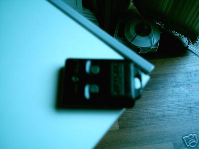

Chevy it should be out and the open and look like a simple 2 way toggle switch. One side will have a * on it and the other side will be flat. The problem is that it is coded, and unless the old owner left it at the factory code, your kina stuck.
There is hope though, Tell me what your remote looks like (in detail, or a pic) and I will tell you how to put it in valet mode using the remote.
Untill then, if the buttons make a square hit the top right. If they make a diamond, hit the top center (it will be a large round button). That will get you going with the normal arm disarm stuff.

Hi there is a guy on ebay that sells the intructions he has most clifford alarms, they are like £2.50 i think, hope this helps dude
