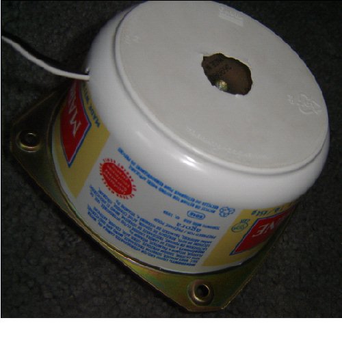

ok, i got some good speakers for my car's door but the stock brackets that held the original speakers are just all open on the back and abunch of the sound gets lost in the door and the speakers distort when they shouldnt be. will this cup i put on there hold some of the sound in and improve the sound or just make it even more hollow?Upload
Username: Mikechec9
Chicago/atlanta
Post Number: 57
Registered: May-05
ha! dude, that is so original. i see a great future in installing if you ever decide to go that way. what is that, hair grease?
if it is sealed, it will plausibly be "better." i bought some foam inserts back in the day from crutchfield when i had the same issue. it improved the hollow problem. they are very cheap and worth the purchase if your grease cup fails. keep being imaginative like that though. i'm really impressed.

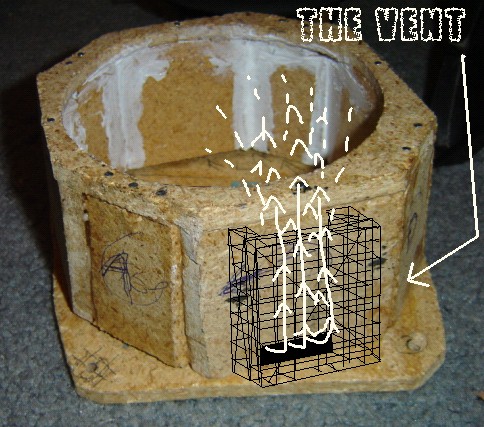

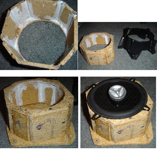

here are my designs and ideas. will they work?
the wooden one i made, the black plastic one is the original one that sucks. then theres my idea for a vent. any other options so i can get some more volume? sealed in tightness like this just muffles and distorts it, so the vent is necessary.Upload

Username: Jonathan_f
GA
Post Number: 3947
Registered: May-04
I'm not talking about that small of a sealed box, I'm talking about sealing the door up, which will provide more than enough airspace. Sealing that wooden box up won't work well, and if you vent the speaker, all you're doing is allowing the rear wave to interfere with the front and cause cancellation, degrading your SQ and frequency response. Not good either way. If the speaker is distorting, it is because it is reaching it's limits, likely playing too low. You need a HPF on those speakers to get them to play cleanly.
