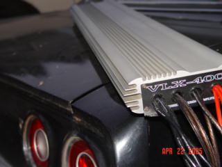

AHH! thanks Glass wolf.I've done alot with car audio over the years but never this extreme.I bought a vlx-400 and learned a whole lot about efficiency.Could be worse though.The experience is great even if by trial and error.

I purchased this bayboy and went a little overboard..I was lookin to run some a/b power to 2 triple x's sealed in my old f350 crewcab!I want an extreme (sq) daily driver.That I could run at normal levels and then on the weekends crank it up at the Pits.I really think I am going to go for two arc audio xxk2500's.They are only 1050 watts apeice.I'm wondering how they will do?Upload
