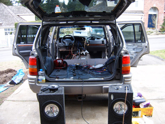

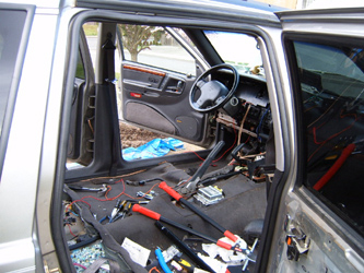

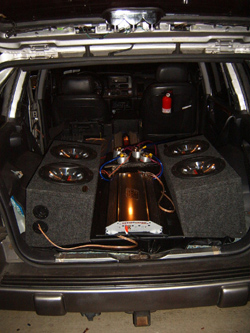

I replace four RF301m amplifiers (one for each sub) with the 2500d.
Its loud but lacks the something in the bass.
The RF301m seemed to have more impact with the 10s hit...
i am thinking about removing the 2500d and reinstalling my 301m's
i have tweaked the 2500d settings for over a month and cannot get the same quality of bass the 301m's provide with the same subs/box/deck
Config:::
1997 Jeep Grand Cherokee w/5.2liter
120 amp alternator (already upgraded from stock 90amp)
Alpine 9833 control unit w/3 4 volt pair of outs
Biggest battery i found at Schucks (not optima)
4X MTX81044a DVC wire to 1.3ohm
1X Orion 2500d
1X RF301x (front door 600cs and dash 1001t infinity)
1X JVC AX4750 (rear door 6000cs Infinity)
4X 6000CS Infinity (each door)
2X 1001T Infinity
4X .5 farad caps (one for each 301m)
4 way Distribution/fuse block (aka door block)
2 way Distribution/fuse block (aka sub block)
0g running from battery to Sub Block (17 feet)
4g running from Sub Block to Door Block (1.5 inches)
4g running from Sub Block to Farad 1 pos
4g running from Sub Block to Farad 3 pos
8g running from Door Block to JVC amp
8g running from Door Block to MTX amp
4g running from farad 1 pos to farad 2 pos =Cap Bank 1
4g running from farad 3 pos to farad 4 pos =Cap Bank 2
4g running from Cap Bank 1 to 2500d power input 1
4g running from Cap Bank 2 to 2500d power input 2
12g runs for all speaker wire
pix:
