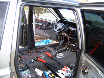

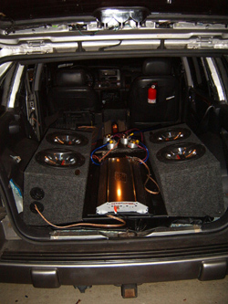

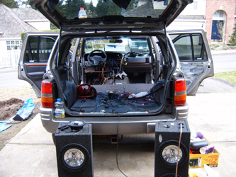

Here is a quick snapshot of what was and now is...
four Rockford Fosgate 301m amps pushing four MTX 81044 DVC 10" subs...
To ensure its done right i started from the beginning and removed everything
now the Orion 2500d is in...
