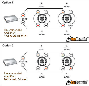

...I'm looking to buy 2 12" subs for this amp and was wondering if it made a difference if my subs had a 2 ohm impedance or 4 ohm impedance...and also if anyone had any suggestions on which subs are the best I would greatly appreciate it! I don't know much, but I'm willing to spend around $300...THANK YOU SO MUCH!
Username: Marley289
Post Number: 21
Registered: Nov-04
get subs that have dual 4 ohm voice coils, that way you would be able to wire it down to 1 ohm. here is a wiring diagram taht might help. use the first option. (option 1)
Username: Marley289
Post Number: 22
Registered: Nov-04
i dunno how the 1000 watt bridged mode works tho if anyone know how to do that then follow what they say
