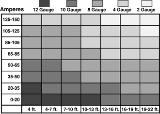

Here's a chart if you want to look at it.Upload

You should use 8 gauge wire because the amp will most likely be over 10 feet from the battery. If the amp uses two 25 amp fuses you need a 50 amp fuse in the line from the battery. It needs to be no more than 18 inches from the battery.
