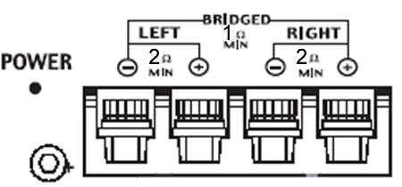

Anyways i attached a picture of the side of my amp... how do i hook up my 2 4 OHM subwoofers to my amp??clarionconfig.jpg

Anyways i attached a picture of the side of my amp... how do i hook up my 2 4 OHM subwoofers to my amp??Upload

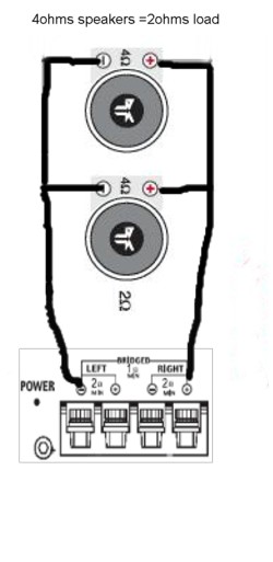

The picture you have has a 1ohms under bridge so I take it that it is 1ohm stable bridged. You will need three 4ohm subs to pull a 1.34ohms load. Hook Four 4ohm subs to pull a 1ohms load. The photo below is for two 4ohm subs. This should push 1000rms bridged at 2 ohms but a lot of amp will not do what they say. Also the watts will be split in between both subs. You might want to look at getting a dual 4ohms sub. That way you can run one sub at 2ohms and put more watts to the sub.
