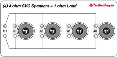

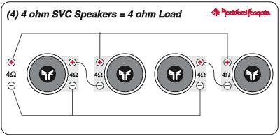

Here is what I could find. Sorry I can’t help you on the other things.I could not find six sub this is four and if you hook more than 4 it might drop the ohms lower.

Six 4ohms sub wired in parallel the amp will see a load of 0.66667 ohms
http://www.the12volt.com/caraudio/boxcalcs.asp

man thanks so much!!I can really see what to do at this page its a great deal of help.i was lost and did not know where to start.now i have 1 last question.ok my amp is 1200.1 right my subs are 200watts rms and 400 peak.lets say i went ahead and got 2 more subs and 1 more amp.that gives me 8 subs at 4ohms and 2 1200.1 amps right and if i hook up 4subs to 1 amp at 1ohm THAT WOULD GIVE ME 300WATTS TO EACH SUB RIGHT BETWEEN 200 AND 400 WITCH THE SUBS ARE RATED and if I do the same with the rest would that be logical?or am i still lost.[LOL]ok i had 2 questions the last one is if that will work do you would think it would hit as hard as i need and would i need to look for anything special in my head unit thanks for the info and thanks for all the future info in advance

If the 1200.1 amp is stable on a 1ohms load it should work with 4 subs on each amp. I don’t know about how many watts each sub will get. Also I can’t help you on your head unit. I think two amps like that with 4 sub on each amp would get me all I would ever want. But you will have to try it to find out.
