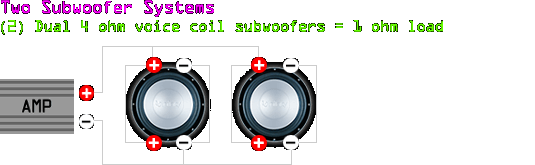

also, here's how you would wire it
this is from Infinity's website...the pic is kinda cruddy 'ca
Username: Drumjunky
Boulder, Colorado
Post Number: 40
Registered: Nov-04
oops..its kinda cruddy 'cause the original background was black

rockrd fosgate's site has a wiring wizard.
tey that
